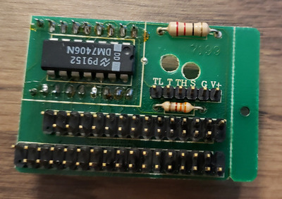

Hi guys, many people asked here about figuring out their turbo displays. I guess my turn came now.
Got this turbo display, and I'm struggling with all aspects of it: setting the numbers, switching between two setups, and finally connecting it to the mobo.
The attachment 20220817_214005.jpg is no longer available
The attachment 20220817_213903.jpg is no longer available
The attachment 20220817_213840.jpg is no longer available
Now, I'd like to start with understanding what are the connectors for: TL, T, TH, S, G, V+.
G & V+ are obvious, and the LEDs indeed come to life when I connect V+ & G to the 5V input source and ground from the PSU.
But what about S, TH, T, and TL? I did toy a little with them and connected the three wires from the 2x3 turbo switch to TL,T,TH though toggling the button doesn't seem to change anything.
I noticed that shorting S to TH does switch the display, but in a weird manner. If I short them, the LEDs change. Then if I remove a cell jumper the matching LED turns off, but when I put back the jumper in its place the LED doesn't come back, unless I unshort S & TH then reshort them again. Does that mean there is a latch circuit involved? The IC on the board is 8 inverters from what I've read.. so I'm not sure where this latching behavior is coming from.
The mobo has a 2-pin turbo switch connector and a 2-pin turbo led connector. But let's focus on the turbo display circuit for now before even involving the mobo in the game. I should be able to setup to different numbers and toggle between them without the mobo altogether.. right?
Thanks for any help in advance!

Reply 1 of 7, by Solo761
Maybe this
S - Turbo Switch ground
T - Turbo Led +
TH - Turbo Switch High
TL - Turbo Switch Low
Or
S - Turbo Led +
T - Turbo Switch ground
To be sure one would need to check where these connections go to 7406 inverter and beyond.

Reply 4 of 7, by wbahnassi

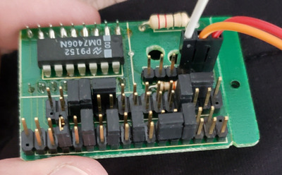

Ok got it figured out. I read somewhere here that the switching is done typically by branching off the mobo's Turbo LED ground connector. So I connected the S connector of the turbo display to a branch of the turbo LED ground line, and the display was correctly switching numbers according to the mobo's turbo state, controlled by the turbo switch button.
Nice, that's two things solved. So TH,T,TL aren't needed in my setup. Though would have been nice to learn what they're for.
The actual LED digit setup is done by the big collection of jumpers. Each digit cell is represented by 4 pins laid out like interlocking T and ⊥. If no jumpers are used, the cell won't light at all. A jumper across the vertical line of the T will light the cell in both turbo on and off. A jumper on the right wing of the T will light the cell when turbo is on. Jumpering the left wing will light the cell only when turbo is off.
Also, this display uses one shared current limiting resistor, which made it a bit harder to try out lighting cells in isolation. If only one single cell is lit across the whole array, it becomes orange instead of green. I guess if you don't disconnect it quickly it will burn. So be careful. You'll need to light up more cells to avoid overcurrent.
With that figured out, I'll need to know what my 486 DX2-66MHz will slow down to when turbo is off, because you'll need to plan both turbo states together when deciding what to jumper.
What tool can give me a good approximation of Mhz when turbo is on vs off?
Cheers!

Reply 5 of 7, by snufkin
Maybe TH,T,TL are outputs for a Turbo LED since the motherboard's LED output is being used to switch the display? Might be able to connect a bi-colour LED to change colours depending on turbo selection.
If your board has a clock generator chip (it'll be a chip next to a 14.318 crystal) then you might be able to look up exactly what the frequency outputs are.

Reply 7 of 7, by wbahnassi
snufkin wrote on 2022-08-18, 17:14:
YES! That's it. As a test, I took the S line from the display and connected it to the mobo's Turbo LED ground. And plugged the actual Turbo LED from the chassis to T and TH on the display. And indeed, the Turno LED now gets its state from the display, and you can reverse the state by using T and TL instead of T and TH. So yes, it can be used for a dual color LED too, but my case only has a single color LED. But yeah, very nice! And I don't need a breakout wire now from the mobo's Turbo LED connector. 👍
