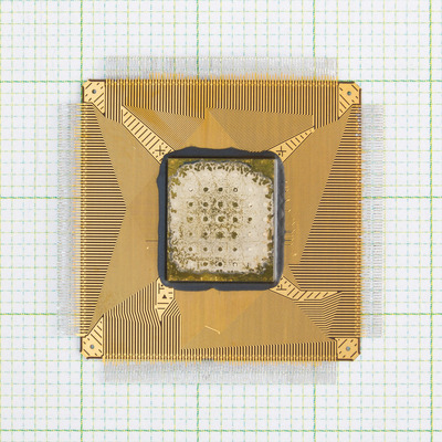

I belive that soldering could be done with good flux and some magnifier, I can use Mantis 10x stereo scope at work. Datasheet drawing shows the pin width is 100um, 250um pitch - JLCPCB should make it. If the chip is the same as used in PGA package then wiring should be straightforward (as bonding in the PGA chip)...
A macro here:

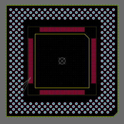

I could create footprints in Altium quite easily via package generator, then careful looking at pin tables will be needed to make netlist directly or sch. parts...

Here's best I have, I used Pentax 17-70/f4 lens that works as good macro lens allowing focus from 8-10cm distance.
http://rayer.g6.cz/1tmp/intel_Pentium_233-66_ … MX_Mobile-a.jpg
http://rayer.g6.cz/1tmp/intel_Pentium_233-66_ … MX_Mobile-b.jpg

For those who aren’t holding one of these in your hand it is positively nuts how small those legs/pins are. Best of luck to the poor soul that tries to assemble one of these

Footprints created, now boring part of filling the netlist...
