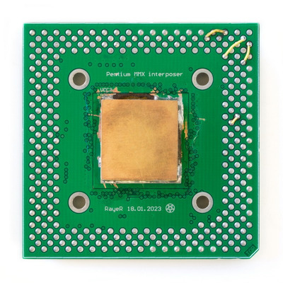

After some issues with further internal shorts and milling more holes and fixing all the mess I finally sealed it by epoxy and soldered the copper IHS back on the top side of interposer. I used my weller solder iron where I simply removed a solder tip and put the IHS to front side of solder pen, turned temp to the max and waited unit it melted and then power off. I also soldered the necessary bridges for voltage and cache (BF2 already set by 0R on bottom side).
Now doing some test at Gigabyte GA-5AA, I solved cache issues by flasing latest beta BIOS F7, see here:
Re: Tillamook 266MHz and working L2 cache?
Gigabyte GA-P67-DS3-B3, Core i7-2600K @4,5GHz, 8GB DDR3, 128GB SSD, GTX670(GF7900GT), SB Audigy + YMF724F + DreamBlaster combo

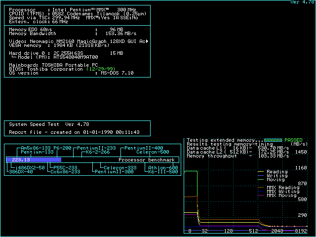

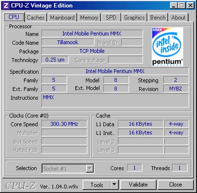

I have been trying to verify the existence of the tillamook 4.5x multiplier for some time. I am beginning to wonder if it even exists? I am wondering if those laptops maybe had 4x 75mhz =300?
CPU-z (vintage 1.04) doesn't really know what to make of it, any other utilities I could try?
13.96 KiB
596 views
Speedsys knows what it is though 😀
10.07 KiB
596 views
This 3020CT laptop is currently assembled and working, but could with some effort be unassembled for measuring pins under the microscope, if you can point to where I should check.

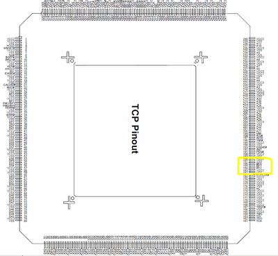

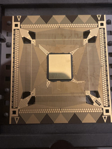

Hm, about the pins.. If you look at the CPU back side photo that I posted on 1st page you can see that some tiny traces going out from the chip are connected together with others and then continues to solder pin as 1. I mean that there are more pins on CPU core side than there are solder pins (320). This may give a very little chance that some of them might be used to configure something - this would mean e.g. that 300MHz Tilly would have sligtly different traces patterns on the foil than others with 4x mul. If someone could take a detailed macro image of the backside then it could be compared with my photo. But I think it would be much more complicated to use different foils in manufacturing of CPU packages than if they would simply LASER trim some fuse on silicon die before sealing.

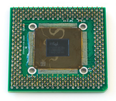

Here is a 266
    1.56 MiB
    482 views
Sphere's PCB projects.

Good photo but 266 is also capped to 4x, right? So there shouldn't be difference. We need to get photo of 300 version.

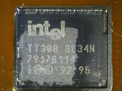

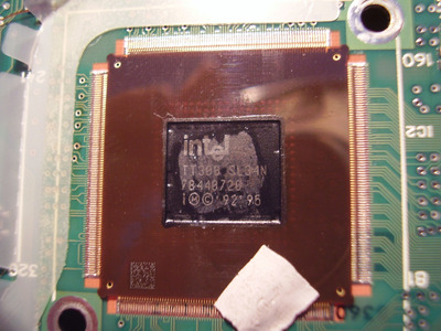

I found an old photo I took of the T300 in that Toshiba I mentioned :
417.73 KiB
440 views
300MHz Tillamook
Reply 117 of 134, by RayeR
I mean photo of the back side to see routing pattern. Of course don't solder it off from your working device, maybe if someone would have a spare part or some dead laptop...

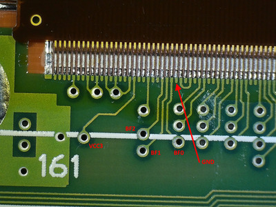

Reply 119 of 134, by Thermalwrong
RayeR wrote on 2023-11-24, 00:00:
I would bet it's BF2:0 = 1 0 1, so let some owner try to measure it on his laptop. But I'm not sure how valuable this info would be as lower CPUs are already locked. Intel don't give bonus easily as AMD. AFAIK nobody was able to unlock multi on intel there was only some unlocked engineering samples, the same for SMP...
Thank you for the pointer image, I don't know much about the pinout on these types of chips so that helped 😀

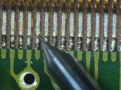

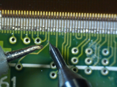

I bought some carbide mini drills the other day and immediately broke the 0.1, 0.2 and 0.3mm bits, but there's enough left that the 0.1mm can be used as a probe tip:
474.14 KiB
232 views
635.75 KiB
232 views
That turned out to be less necessary than I thought, the BF pins are clearly routed to nearby vias:
651.74 KiB
232 views
803.8 KiB
232 views
So the layout was as you suspected, this makes it 1-0-1 right?:
BF0 vcc3
BF1 gnd
BF2 vcc3
