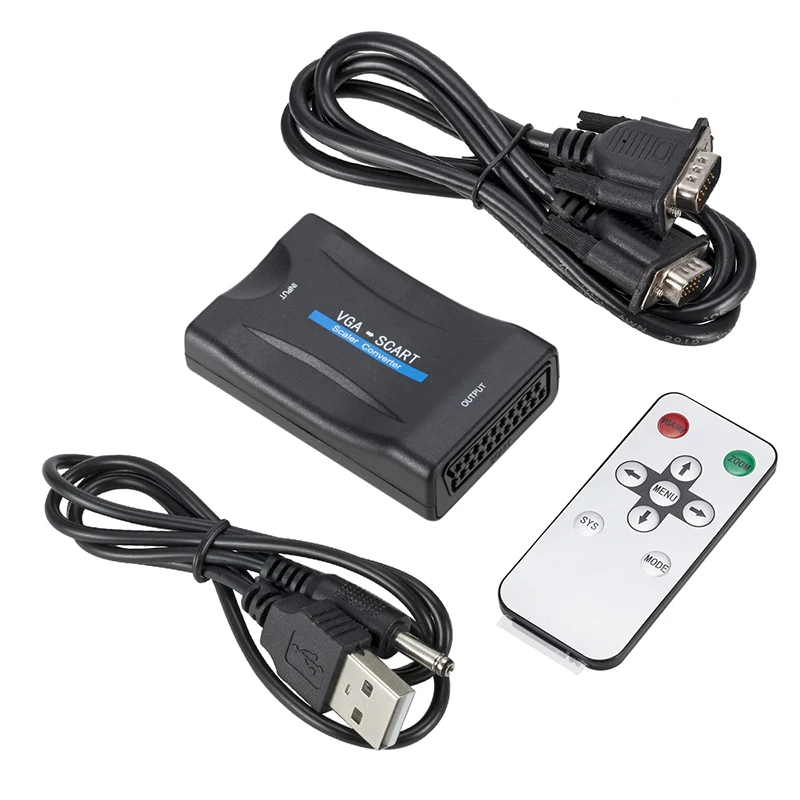

This adapter seems to be good, it has it's own remote control, which lets me to change position and size of the screen. I can move the screen in all directions, but the missing part of screen doesn't appear.
I messed something, because I tried to change resolution in Windows 3.11 and suddenly my hard drive stopped working - I have "missing operating system" right now. I will try to fix it.
I found that it should be fixed by service menu in tv, but I don't know how to enter it - I tried holding CH+ and Vol-, CH- and Vol+, etc, nothing works. My CRT is Sharp DV-5451, would you be able to check if it has service menu? I can't find it in Google.

You are right that it's the converter's fault, but I didn't find anything better. If you know aby better adapter, then let me know - probably people in the past were also connecting their computers to crt tv, it seems impossible that noone did that. I have old computer and old tv and I need to connect one to another. How people were doing it in the past? Are there aby better solutions? I know that the best would be to buy the monitor, but is it impossible to correctly view the screen from old pc on old crt tv? Of course I am not able to build my own adapter.
The solution would be to change aspect ratio in games, to add borders around them or to run them in window mode. Windows 3.11 can run Ms-Dos prompt in window, but the games will probably go full screen anyway?
Some games have buit-in screen control, for example Doom - you can squeeze the screen and add borders around, but there are only few games which can do that. And it squeezes the screen from all sides, and the problem is only on left and right.
Thankfully, it's only about 1 centimeter from left and right, which is not visible, so it's not a big deal, but of course I would prefer to see the whole screen.

Do you think that it will be better than mine? This is what I currently have: https://ae01.alicdn.com/kf/HTB18nlOMgHqK1RjSZ … wania-kabel.jpg
it removes conversion altogether from the equation, converters need some heuristics as to what to capture and how to convert it, they are usually made to work ok when plugging a laptop to projector/tv to do a powerpoint presentation, but suck at atypical/dos resolutions.

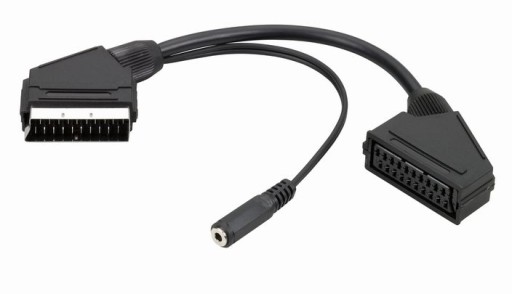

Shit, now I'm not sure whether the cable from the shop is vga to scart or scart to vga. It seems that it's scart to vga, so it's not what I need.
As I'm searching in the internet it's extremely hard to find any cable which description says vga to scart, not scart to vga. Seems that I'm unlucky. I found one offer, but it's an adapter, not a straighforward cable - so I would need to connect vga-vga first to this. What do you think? It's the closest to what I need which I found: https://www.olx.pl/d/oferta/kabelek-adapter-v … 99-IDFtQGL.html
It's easier to find vga to rca cable, than vga to scart. I also have adapter from rca to scart in home, so maybe it would work? But first tell me about the link above, will it be good solution?
You already have scart-scart cable, unscrewing one end will give you access to all the needed pins. For the experiment you will need soldering iron, some solder, two ~1K resistors, bunch of loose wires to connect everything up and 6 pins (resistor legs will do) to stick into VGA connector on your card to make a temporary plug. Sketchy, but works if you are careful https://www.flickr.com/photos/puregin/3709319216.
https://www.geocities.ws/podernixie/htpc/cabl … n.html#vgascart diagram shows rear side of VGA male plug, looking at teh VGA card female plug pins are mapped like this http://www.filmmaskiner.dk/kvs/01/pincount.jpg
