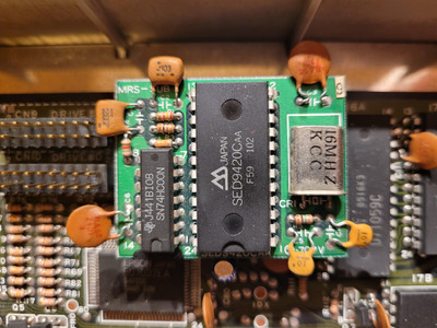

I assume, that the drives are good, but the controller may be sad. I have seen there is a daughterboard with an SED9420CAA chip, which seems to be responsible for the FDDs but I'm not sure.
Thanks!
Reply 2 of 21, by mkarcher
You are likely on the right track. The SED9420 is a part of the floppy interface. It's the more "analog like" part of the floppy interface, it's called the "data separator" and is responsible to capture the data rate of the data received from the floppy read head, so it can be processed by the floppy controller. The floppy controller chip likely has a designation like "765" in its model number, referring to the NEC µPD765, which is has been licensed and/or cloned by nearly any respectable integrated circuit company in the 80s, as it turned out to be very widespread after being used by IBM in the original IBM PC.
Re-plugging the floppy control cable and re-seating the floppy controller daughter board may be good first troubleshooting steps. If that doesn't help, a photo of the controller card might give clues how to troubleshoot it.

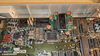

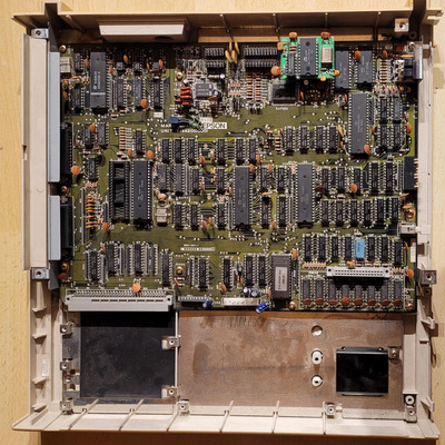

Reply 3 of 21, by The2Faces
Hi all,
I just did some work and disassembled the Epson PC completely (til I reached the Mainboard) hilarious, what you had to do back in the days to get down to the mainboard 😉.)
I will upload all pictures I made to a image hoster, due to the limitation to upload 5 pictures max for one reply.
Drives will follow.

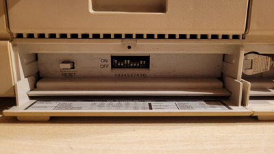

Reply 4 of 21, by Horun
Great pictures ! Have you checked the condition of the switch bank ? The Equity 1 has that switch bank from front panel,
if SW8 is not making good contact could upset the "one or two" floppy drives present or cause odd floppy issues.
Just a long shot thinking but switches on some of my old gear seem to be one source of irritation 😁
Assuming you have the manual to Equity one you know which switch am talking about...

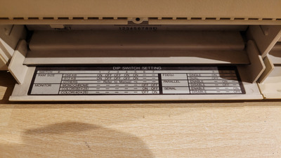

Reply 5 of 21, by The2Faces
Yes I have a description of the dipswitch thankfully still attached to the front plate:
Thankfully I also found a english version of the Equity I manual somewhere on the web, which I just have attached to this thread.
Unfortunately I played around with the dip switches, without any changes in the behavior of the issue.
Maybe I will just use some contact spray to ensure the contact for PIN 8, but yet nothing changed for both settings (Single FFD = PIN8 ON / Dual FFD = PIN8 OFF).

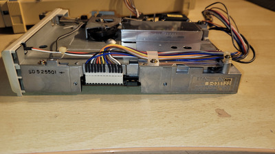

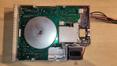

Reply 6 of 21, by The2Faces
So see the drive pictures attached.
On visual inspection I have more and more doubts, that the drives are the issue.
Unfortunately I can not just take another controller to hook the SD-525 floppy drives up, because of the missing shugart floppy interface, which was seemingly added later to the SD-521.

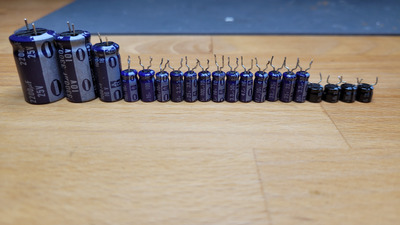

Reply 8 of 21, by The2Faces
Hi all,
I know this thread is pretty dusty, but I rather would like to use this thread to document here the process to revive the drives.
Since the last time I posted, I had some time finally to redo all caps on the Equity I.
Unfortunately, this had little to no success, but at least, the device is not more broken than before.
It still boots with the "disk error" from bios, but the drives still do not seek during post.
I will try to create here a list, which kind of Capacitors, where put in which places on the board, but this will require some time.
Currently I plan to check on the D765AC, which is the main floppy controller (seemingly). the SED9420CAA seems only to be a data separator, whatever that might be. I have now spares from china questionable if they are legit, but maybe worth a try.
In the meanwhile I will check again on the drives, if these are may be the issue.
    973.51 KiB
    467 views
    Replaced Panasonic Caps from the Equity from mainboard, powersupply & ISA 8 bit interface card.

You can leave SED9420CAA alone, its responsible for reading data, not moving heads. Im pretty sure for the PC to move Head it needs to somehow detect its not over track 0. Is there a sensor in the floppy? or instead of looking for the sensor move head manually to middle position and start computer. Error might be triggered by something trivial like one of the wires connecting floppies being broken/loose. Does the documentation have diagrams? floppy pinout?

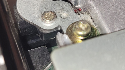

Reply 10 of 21, by The2Faces
I just had yesterday a look again, and yes, the drives have a light barrier to detect either track 0 or at least max. most outer position of the read/write heads.
I made for this purpose a small picture.
Light barrier open, with the sled of the heads oriented to the front of the drive:
912.76 KiB
413 views
Light barrier closed, should represent track 0:
951.57 KiB
413 views
I did some additional tests.
I manually moved the heads to track 0 and checked the behavior of the drives -> nothing.
When I moved the heads out of position of track 0, -> no reaction as well.
During my research I tried to find a maintenance manual on the Epson site, but unfortunately there seems to be only one for the Equity II , which differs massively from the Equity I in regards of the architecture of controlling the drives.
Maybe someone of you might have something in your Shelfs.
Reply 11 of 21, by Deunan
The2Faces wrote on 2024-02-24, 11:22:

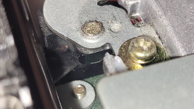

Most floppy drives will auto-seek to track zero on power-on. Though not all, some really old ones don't do that.
First, there is some dust there, perhaps enough have gathered in the slot of the light barrier - try blowing some air in there to clean it out. And/or you might be able to sweep it with some soft brush, if it has hair long enough some will reach into the slot.
Second, since you moved the sled and it seems to move fine - try moving it when the PC is turned on and the floppy is powered. There should be a resistance now - that is, the stepper motor should hold position and not let you move the heads easily. Don't try to overpower it, just check if it holds the sled or not. If not you might have a problem with the logic chip in the floppy drive itself. This can be dangerous to the stepper motor, sometimes this results in 12V applied to one or more of the coils and the motor will overheat in few minutes, so if you suspect that logic chip do not leave the machine turned on too long.
EDIT: Looking at the PCB I don't think this drive even has a logic chip on it, seems like the PCB is only populated with motor coil driver chips and all the logic is handled by the PC. Is it possible to unscrew and make a photo of the upper side? That at least would tell you if the stepper chip is just a dumb driver or does it do timing and sequencing on its own, and takes direction and step signals from the PC. In the latter case it might be possible to test it with some jig (power supply and some buttons).

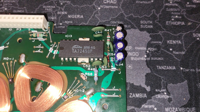

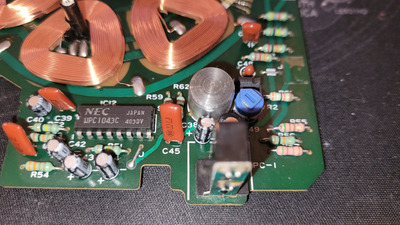

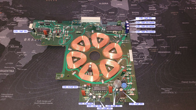

Reply 12 of 21, by The2Faces
I recapped both drives now, without any change of behavior.
Also I did some additional testing on MS Dos level. Seems like, that the controller does not see in any way the drive.
Interestingly I'm able to trigger the drive, that the LED jumps on and the drive spins, but no reaction of the stepper motor for the heads.
If there is any resistance on the stepper motor, when the drive tries to access the disk, I have not yet tried.
For documentation purposes I made markings of the replaced caps and their original value. (only the bipolar C33 to C35 ar original)
1.44 MiB
374 views
Lower part of the SD521A with motorcontrol IC
1.93 MiB
374 views
Upper right part of the SD521A with motordriver IC and bipolar caps (blue)
1.71 MiB
374 views
Upper left part of the SD521A with TTL monostable multivibrator IC
1.79 MiB
374 views

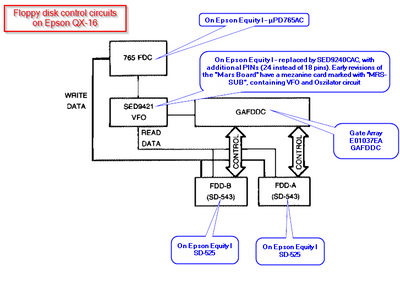

So overall there is not interface control circuit on the floppy drive, like on drives with an additional on top pcb with e.g. a Shugart interface.
This seems to be on mainboard of the Epson Equity I.
My research on that was, that either the GAFDDC / E01037EA of Epson (see pictures above) or the Hitachi HA16642MP have an issue.
By the way I replace the SED9420C with another chip, resulting in no post. Seems like I was delivered either a faulty or fake chip. Also same situation is, if the additional MRS-SUB board with the SED9420Caa chip is not present, the Equtiy does not post.
I tested also the FDD main controller µPD765A on the Equity by replacing it with another chip of the same kind, without any changes.
Reply 13 of 21, by Deunan
The2Faces wrote on 2024-02-25, 12:20:
No need to wait for disk access, the sled should become "stiff" when system is powered on.
With the photos of the other side of the PCB it's now possible to figure out the circuit, and I have to say I'm a bit surprised it's a double-sided PCB but still has no hole plating and there are still jumper wires used.
Anyway, the 74LS423 is just a '123 except with minor improvements to how it works. That's a timing chip and I belive it's only purpose is to limit the current through the stepper motor windings when there's no head movement. The actual stepper phases are generated not by this PCB but the main board.
So first check the sled when system is powered, if it's "limp" and you can move it as easily as when not powered it would suggest either a complete failure of the stepper driver chip, or perhaps those two transisors above 74LS423 are blown.
The motor windings are connected directly to the big white connector, looks like pins 9-12, see where that goes on the main PCB. I would expect some driver chip, maybe even good old ULN200x series, to be there. The 765 FDC only has 2 outputs, /DIRC (direction) and /STEP - so there must be some logic that translates that into stepper motor coil phases, and a driver (that could be one custom chip for both).
You can check if the 765 generates stepping pulses, if you don't have a scope then an LED with 1k resistor will do. Steps are at least 3ms long and the pulses should cause the LED to blink. Make sure to move the sled out of track 0 sensor range for this.
Reply 14 of 21, by The2Faces
Thanks for your input. It tested the sled -> total limp. No activation of the stepper motor in any situation.
I poked little bit more in the internet, and found a service manual for the successor of my model (Equity II). There are the SD-521 drives also built in, which are nearly the same, with the difference, that each drive has its own control circuit (top-board), which the SD-525 not have (only the mentioned motor control board / bottom part of the drive).
Thankfully there was a schematic inside 😁. You were nearly wright.
Instead of the pins 9 - 12 it is 10 - 13, which go from the stepper motor to the main board.
To ease up the diagnostics, I have put the the pin-out of the P3 (white connector) together:

Reply 15 of 21, by Deunan
The2Faces wrote on 2024-02-25, 19:42:
I will update you as soon as I have solved the issue with the covered board for probing.
See if pin 5 of the stepper motor connector (on the drive PCB) is at 5V. This should be its default level and this voltage should raise to 12V when stepping. If you can't easily access that point then solder or clip a wire to it for testing purposes.
If 5V is there and the sled is limp it's either the failure of the driver for all 4 phases (dead chip or has power delivery issues) or possibly the motor itself was overheated before. Test all the coils in the motor, there should be an equal resistance from pin 5 to pins 1-4 on the connector. What the driver chip does is provide a ground to one (or two if half-stepping) phases. If all of the pins 1-4 float at the same voltage as pin 5 then you pretty much nailed the problem to the driver chip.
If there is no voltage at pin 5 it might be a damaged transistor or a broken connection somewhere on the drive PCB. It's unlikely but not impossible - and frankly would be easier to fix so I don't expect such luck.

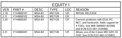

Reply 16 of 21, by The2Faces
I have checked the voltage on Pin5, which is 5V and keeps 5V and nothing bejond.
The coils are all for the steppermotor are all between 146 - 150 ohm, which seem to look fine.
I replaced the 74LS423N on one drive, with a known working chip just with the same result, that the BIOS reports DISK Error.
I do not think that the drives (both) are the problem. Currently I try to figure out, why the BIOS detects there the drive error.
I just dumped for that the current BIOS with revision 2.1I, which is the second release, of four.
See here the list of the available ROMs:
Epson_Equity_I_BiosRom_V2_1I.zip
6.5 KiB
6 downloads

I think so too. 5V being present and the coils not open, the stepper should be holding the sled in place. It's not because none of the pins 1-4 are getting grounded by the mobo.
BIOS might have a floppy seek function and it simply times out trying to step the head out of track 0 position and back.
The2Faces wrote on 2024-02-29, 23:15:
I find it curious that two of four BIOS releases had some fixes to floppy drive handling. But then again this mobo uses non-standard floppy drives with most of the logic and signal processing being on the mainboard instead.
Looking at your mobo photos again, I don't see any typical coil drivers but there's a bunch of of transistors there, near floppy connectors. It's rather unlikely that all of them got blown so I wonder if there is a fusible resistor somewhere, or a broken connection?
I'm pretty sure the chip responsible for the stepper phasing is the Epson GAFDDC - that's a gate array chip, a PLD of sort except factory-programmed, I couldn't find any datasheet for it. Some of these early gate arrays can just die, and they do tend to get rather warm during operation. I spy a test point nearby marked STP - could be step signal from the D765A, if you have a scope it would be worth checking if any pulses show up there. Or on the D765A output.
Reply 18 of 21, by The2Faces
Thanks again for your Input.
I had the same thoughts about the GAFDDC and I really really hope that this chip is not toast. Just for the reason, that it is nearly impossible to source it new to replace with an FPGA without the help of EPSON.
Regarding this chip I made also some additional research, which led me to a service manual of the Epson QX-16 PC, which was kind of a wierd mix of Zilog and 8088 chips.
But the most important part lies within the service manual, which explains, how the GAFDDC works, together with slightly different drives (SD-543 instead of SD-525).
To give you here an example, this block overview helps a lot to understand, how the whole setup was done by Epson back in the days.
49.98 KiB
231 views
Here is the interesting part for the floppy drives I pulled from the 174 pages service manual:
Epson-QX-16_Floppy_Controller.pdf
4.89 MiB
7 downloads
I will check the 16Mhz crystal for the value, but currently I have issues to find my damn oscilloscope.
Let's see tomorrow, what I will find out.
Reply 19 of 21, by rasz_pl
The2Faces wrote on 2024-03-02, 00:06:
worst case scenario you could desolder everything behind D765 and graft in guts from another floppy pcb to handle stepper motors.
As deunan said measuring pins 33 35 37 of D765A is a good start. pins 69-77 of GAFDDC will also be interesting, and 68 TK0 and 2? for TK1.
