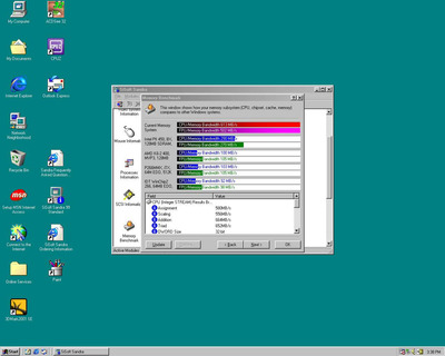

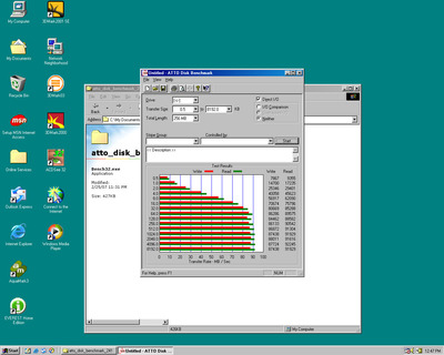

Base performance & Comparison with I440BX (ASUS P3B-F)
First of all, I decided to assess the performance of the board under stock settings to see where we stand, and to do this I ran the same benchmarks on a comparable system using the performant I440BX chipset, and one of the fastest ones at that - the ASUS P3B-F.
I benchmarked both systems with the same CPU, RAM, GPU, PCI SATA Controller and SSD, using Windows 98SE with the same GPU drivers.
The benchmarks performed were SiSoft Sandra 99 RAM Benchmark, 3DMark 2001SE and Unreal Timedemo.
Listen. I knew the performance of the M747 was supposed to be less than stellar. But I did not expect *this*.
Let's start with the P3B-F's numbers:
  • 2810 3D Marks
  • 280 MB/s Read (matched its prediction almost exactly!)
  • 41.5 FPS
... Here's the M747. Buckle up, everyone.
  • 2100 3D Marks
  • 110 MB/s Read (?!?!?)
  • 23.4 FPS
Wow. F*ck me sideways.

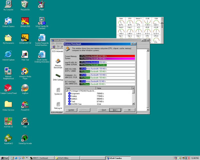

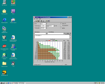

Initial benchmark results
So, where do we stand performance-wise after all of this? With so many bits bobbing, we must have reached unprecedented performance realms, right?
Well, for this particular board ,yes. At this stage, the benchmark results are as follows:
  • 2690 3D Marks (+590 3D Marks)
  • 170MB/s Read (+60 MB/s)
  • 37.6 FPS (+14.2 FPS)
Wow. We're only a few FPS short of the BX and 3DMark is looking better too! But as usual with the cheaper chipsets, the RAM throughput is severely lacking, being outperformed even by the MVP3 on the AMD K6. This is a real shame and probably the reason why the numbers are so tragic.

FINAL BENCHMARK RESULTS
  • SiSoft Sandra 99 RAM Read: 214MB/s (+114 MB/s!!!)
  • 3DMark 2001 SE: 2877 3D Marks (+777 3D Marks!!!)
  • Unreal Timedemo: 43.8 FPS (+20.4 FPS!!!)

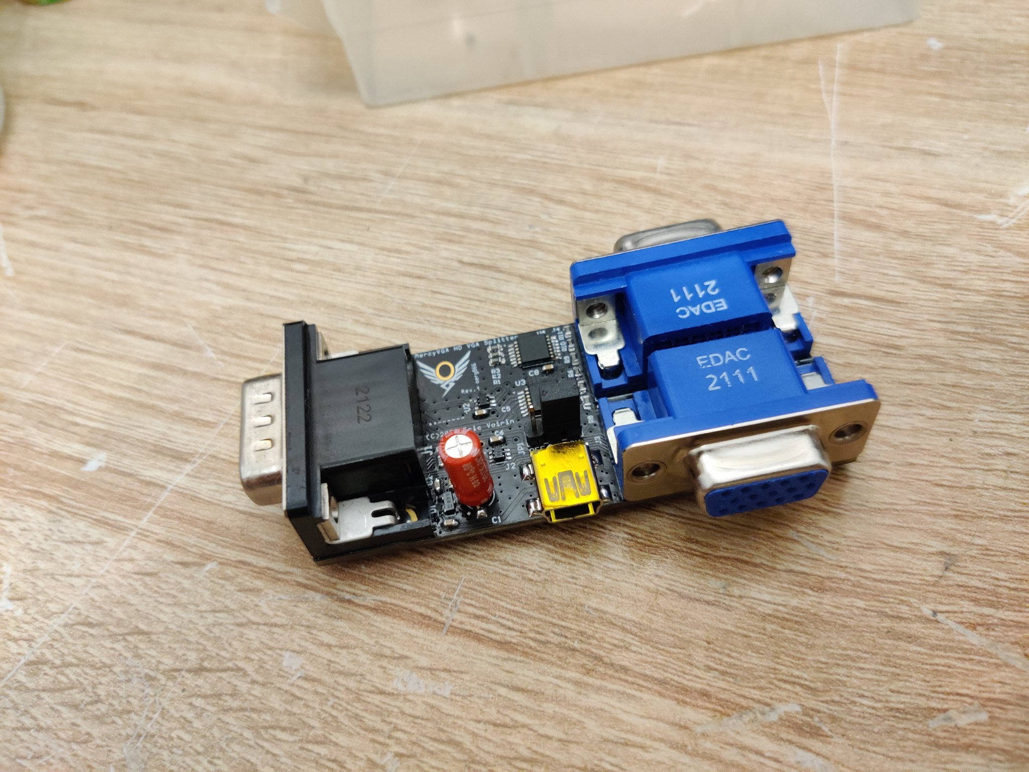

1. What is the thing plugged into VGA? some kind of VGA splitter? I saw passive ones with not that great picture quality, but yours is power over micro usb?

1. Yes, it is an active VGA splitter built by myself because I didn't like existing designs 😀
E7ZZf4sXoAM-Xpe?format=jpg&name=large
Infact the mini USB is only required when there's no +5V on the VGA connector 😀
