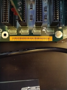

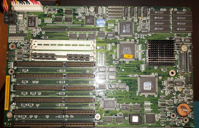

I found an AT 486 motherboard at an electronics resale shop with an included Intel A80486DX-33. I popped-in a 72-pin SIMM that I found elsewhere in the shop, and brought it home. Everything there is sold as-is, but I figured it was worth a try. I ordered an AT power supply, and inserted my Micro-Labs Ultimate VGA/TrueColor ISA card (Tseng Labs ET4000 graphics), which was working last I checked. I also swapped the CMOS battery with a new one.
Unfortunately, I got no video output, so I grabbed an ISA PC analyzer diagnostic card to get codes. It appears to stop at the "00" error code, which the manual tells me means the following: "Code copying to specific areas is done. Passing control to INT 19h boot loader next".
I believe that means it should be handing off to the disk's bootloader (no disk is here, since I have no controller card). If that were the case, shouldn't I still see some video? I wish I could troubleshoot with dip switch settings, but I have no clue what board this is (see attached images). I don't even know where to plug-in the PC speaker from the diag card. The only identifiable number that I can find on it is the following (which yields no search results on the web): 5320962-1RA0231962
Am I out of luck? What should be done next?

Kinda looks like this Dell system board - https://theretroweb.com/motherboards/s/dell-s … 6-xx-mdt-rev.-2
There's an old support page here with more info - https://web.archive.org/web/19970617044811/ht … 24M/default.htm
Maybe try the onboard video as well?

that simm doesnt look plugged in correctly, at least in the first picture
this motherboard does look Dell/HP/some other corporate vendor, dont like those
Imo main reason you dont see any video and post card says its time to boot is build-in VGA on the motherboard gets initialized as first, and afaik you cant have two ISA VGAs installed at the same time. You will need to locate pinouts and make your own VGA dongle.
good news is WDC90C31 is a VLB design, so graphics speed should be perfectly fine. never mind, I got confused by https://www.recycledgoods.com/western-digital … bus-video-card/

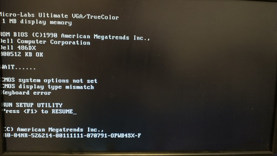

Reply 4 of 13, by rootinit
PC Hoarder Patrol wrote on 2022-11-29, 03:36:
Kinda looks like this Dell system board - https://theretroweb.com/motherboards/s/dell-s … 6-xx-mdt-rev.-2 […]
rootinit wrote on 2022-11-29, 02:36:
I found an AT 486 motherboard at an electronics resale shop with an included Intel A80486DX-33. I popped-in a 72-pin SIMM that I […]
You are a wizard! It is that board, and I disabled the onboard video. I then got video out! Unfortunately, after letting it sit for a moment, the screen turned white, and now the same bad behavior occurs. Not sure if this is a problem with my video card, or if this board has other problems. Will have to test with other machine(s) to make certain. Thanks again though, I have way more information than I did before. Not sure how you managed to identify it, but kudos for having a great eye/memory.

Reply 6 of 13, by rootinit
flynth wrote on 2022-11-29, 04:52:
Are there any codes before? Or just 00 all the time?
There are codes before. It seems to be working properly.

Reply 7 of 13, by rootinit
Tested the VGA card in another machine, and it works fine. This board is wonky.

Reply 12 of 13, by rootinit
I've been further testing and documenting. Not expecting anyone to give me a response or solution, just wanted to document here. Turning it on after being cold seems to make it more reliable to boot. After it warms-up, and I restart it, it tends to have the no video problem. I've documented the codes that are reported from the ISA diagnostic card in both situations. They are two very different sequences of codes. The descriptions of the codes are transcribed from the PC Analyzer's user guide, and are probably poor Chinese translations, but they are included for reference.
One other thing that I've noticed is that when it does show video, the amount of detected memory is reported as seemingly random different numbers.

Here is a grab of what is displayed on the screen when that is done.

Reply 13 of 13, by rasz_pl
http://mrbios.com/techsupport/award/postcodes.htm "AMI WinBIOS; 12/15/93 Onwards"
Were you resetting instead of powering off? that would explain second sequence being shorted, doesnt need to detect any hardware/ram if its a warm reboot.
- Counting memory wrong + first picture with badly seated simm - maybe sim socket is damaged? it wont necessarily be visible, try one simm in different one.
- Measure 5V on the vga card when it doesnt show any picture
- put few books under the motherboard so its fully supported laying flat and vga card bracket can hang loose, discharge yourself (touch metal pipes in the house), press with one finger one chip at a time (start with big OPTI ones) and power system on while pressing that chip, go to the next until maybe you find something funny
- trace the pins I gave you earlier to that header near WDC chip and make VGA dongle, test if same thing happens with integrated graphics
