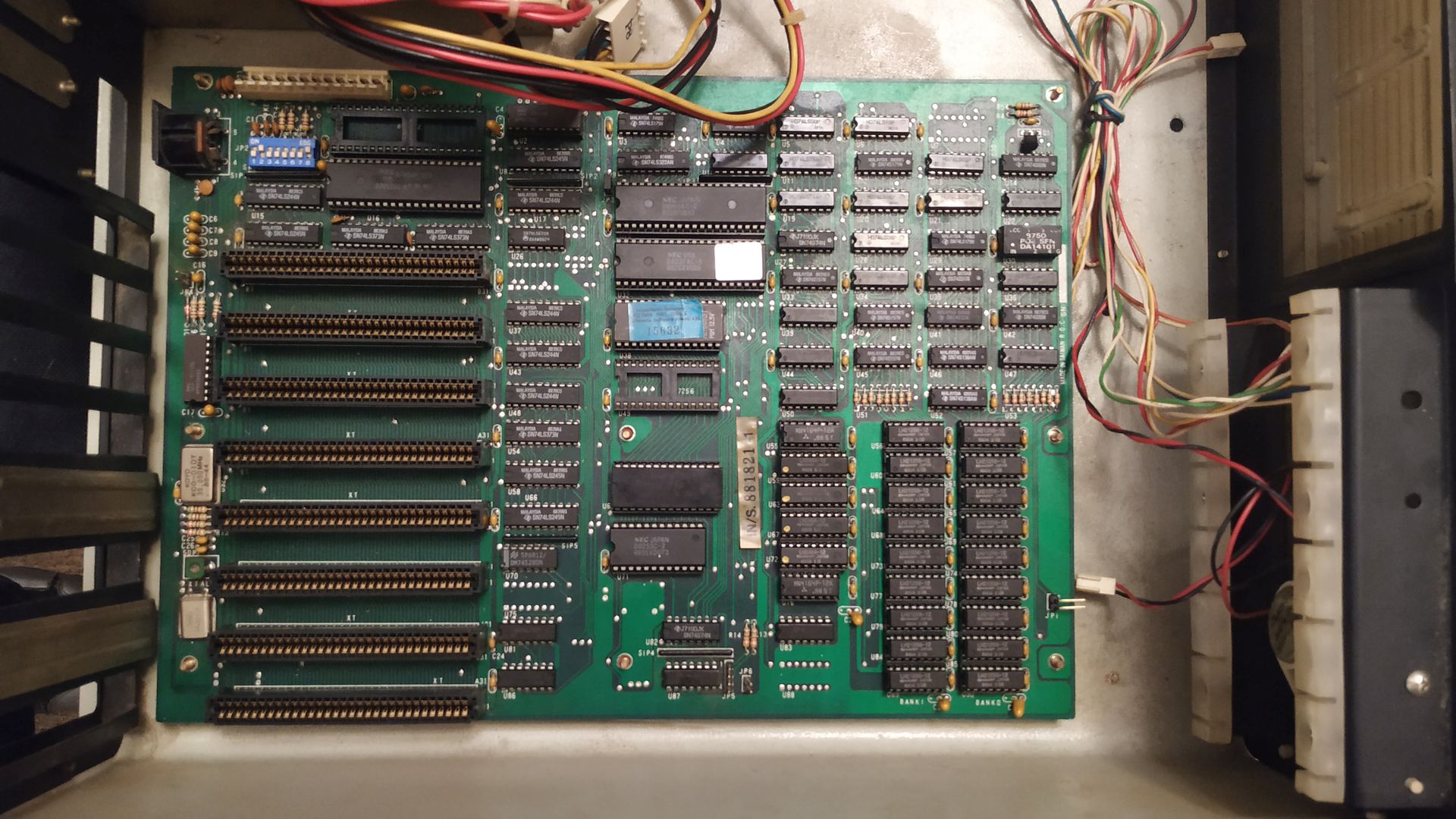

I'm new around here and i need your help.

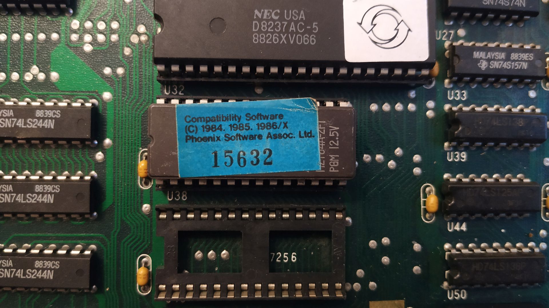

I was working on revival of an old XT PC, while i was gone my co worker inserted Bios chip (2764) and fried it.
Now i need your help to find .bin file for it. The are no clues what motherboard it is (no model number no manufacture, nothing).
Please help.
Photo of the motherboard:
http://mally.tim.com.pl/XT2.jpg
http://mally.tim.com.pl/XT1.jpg

I'd try my luck with a random Phoenix BIOS from a generic XT clone like this.
I think member HanJammer used to also own this computer. Maybe he still has it and can provide the original BIOS? I'll quote one of his posts so he'll get notified about this thread.

You have a good memory. Yeah, I do own it (attached is the dump from this exact machine). It's just a basic Phoenix BIOS, like you said. Any will do. However I would go with Super PC Turbo XT BIOS (https://www.phatcode.net/downloads.php?id=101 https://github.com/virtualxt/pcxtbios ) as it's semi-modern and simply much better.

According to links you provided, i can flash other rom. But instructions are bit fuzzy to me. It generates some files.
I got two sockets one for 2764 (for bios) and unpopulated 27256. What an where should i flash?

If I remember correctly you just have to run make_win.bat and it will compile the rom files in the eprom directory. I'm pretty sure procedure is explained in the attached readme file.
Second socket on the motherboard can likely be populated with the BASIC rom (you would have to concatenate the original IBM rom file in the correct order as the original BASIC came on four 2764 roms). I don't really find it that useful when you can simply boot the machine from the FDD or HDD and run QBASIC which is better anyway...

It woks!
I burned original bin and Inswell is alive.
Thank you very much. (Wielkie dzięki !)
