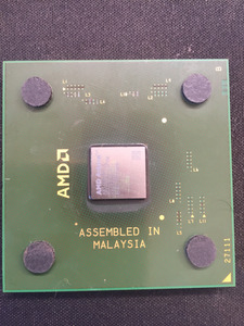

Hi ,
many socket A motherboards with an isa slot (kt133) don't have a multi selector or fsb selector . Here is a pic with a hard modded Palomino 10.5 x 133 and how to get a 14x multi from it . Don't go to deep with the cuts , they are on the surface , do it gradually and use a multi/ohmmeter to check the conductivity of the traces . In the end you should get from a 10.5x , a 14x . It does not affect fsb , vcore or cpu cache . Do it at your own risk !

I’d imagine all he’s done is a hardmod on the bridges (cutting some with an xacto, filling some of the pits with cyano and then painting the bridges with demister repair paint) and following a bridge calculator like this one:

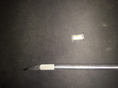

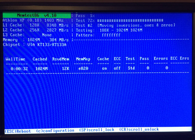

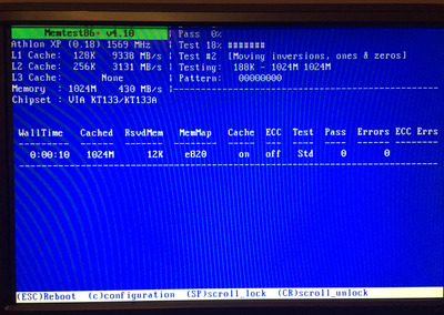

I started with a Palomino 1600+ ( 10.5 multi so 1050 ) . I used a Palomino 2100+ and some models in between pictures to get an idea of how the L lines are organised , then i used a Athlon SFF 1600+ picture so i can roughly extrapolate which are used for multi ( L3 , L4 and L10 ) , fsb and core . For the mod i used : a multimeter , a soldering station ( flux and solder ) , a cutting tool and thin wire from a phone speaker . If you have the Thunderbird core which is ceramic you can use electrically conductive paint or something similar , so you can scrap the soldering station and the thin wire from the list . However if you have Palomino or newer , they are on multi layer textolite . If you use a microscope to look at the original factory cuts , you can already see the second layer with traces so using a conductive liquid/paste it's a no go , or you can do it , but risk abnormal behavior/damage . The traces that you have to cut/connect are on the top layer and lead to the points encircled ( i used a L1 image because it was handy , but it's the same thing ) . You can use them to solder a wire if you need to connect or measure for continuity if you need to cut ( again , if you need to cut , take your time , do it slowly . It's very easy to get to the second layer and risk damage ). In the last pictures you have the cpu running at 1400 ( 14x100 ) and 1569 ( 14x112 which is the max for my motherboard ) .
