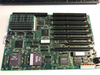

Reply 12 of 57, by Jo22
Sphere478 wrote on 2022-12-22, 03:03:
kolderman wrote on 2022-12-21, 23:56:
If the motherboard could hold 4000 1mb EDO sticks, sure.
Did 386 have edo?
Old full-size 80386 mainboards had local bus slots, similar to VLB, but proprietary.
They allowed the installation of 32-Bit memory boards.
With these slots, it would be possible to bypass the chipset's memory controller and install memory directly on the front side bus.
In essence, it's the same as using big ISA memory boards in an 80286 system.
Edit: Samples picture attached.
    219.8 KiB
    1615 views
    https://retrocomputing.stackexchange.com/questions/6747/what-make-and-model-is-this-386-mainboard
