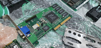

If you want something fancy to fill the agp slot usually anything from canopus would be something collectible that fits the bill.
I use this canopus spectra geforce 256 in my 98 rig alongside my voodoo 2's in SLI , its a bit fancy and lets you have some nicer higher resolutions for the windows desktop since it has 32mb of ram whilst also having good for the time direct 3d performance.
804.69 KiB
948 views

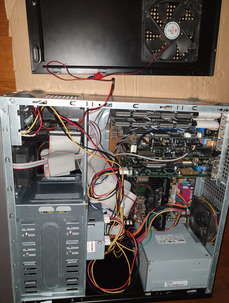

Honestly you might be better of with a card that does 2D and 3D in the agp slot since it would let you play games from another API and increase compatibility , doesn't have to be the card I listed could be a rendition card or ati or whatever.
Also since the voodoo 2 is an addon card you can pair it up with another pci card that can act as a display card for a grand total of 3 apis!
Maybe even 4 if you threw in a powervr card which is also an addon card.
Which is how I've set it up in my rig , I've got a 256 , voodoo 2s and a matrox mystique for 3 different apis and therefore better compatibility.
Just remember though its a bit clunky since you will need to pick the primary display device in the bios , you should be able to select between boot from agp or pci.
1.44 MiB
948 views
Reply 18 of 30, by Ozzuneoj
AppleSauce wrote on 2022-12-28, 16:05:
Is that a BTX case or am I just seeing things this way because you're in Australia and I'm in the US?
Reply 19 of 30, by AppleSauce
Ozzuneoj wrote on 2022-12-28, 16:16:
😆 everything's upside-down here in didgeridoo land.
No but seriously I'm pretty sure its atx? though its much newer than that hardware (circa mid to late 00s maybe?)
I basically blew all my money on the hardware and skimped out on the case and just used one I had lying around that I found on a kerb.
