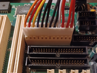

Reply 11 of 20, by stef80
This is how connector should be pluged into the MBO (black wires in the middle):
979.18 KiB
1144 views
And this is switch side:
723.55 KiB
1144 views
Basically, you connect one half of the switch in any order. There are just 2 wires.
Just mesured lenght of the switch wires, it's 75cm (~30 in).
You dont have to plug into the motherbord to test if PSU starts.
