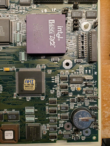

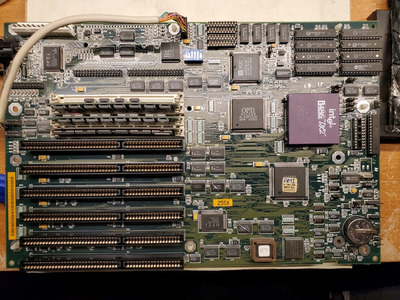

Hello everyone,
I currently have a Dell Dimension 486SX25B. Inserted is a picture of the specific motherboard. I found really good documentation over at The Retro Web with all the jumper settings I need. Except bus speed. I have successful swapped out the CPU for a 486DX-33 and 66. But of course it is at 25MHz bus, so speeds respectively were 25 and 50.
All the documentation I have seen shows this platform came with CPU's all the way up to 66Mhz. And the board has jumpers for such, but no documentation I have found speaks to how to change the bus speed.
Ionge story short, based off my findings, I suspect their has to be a way to change the bus speed, I just don't know what that way may be.

Reply 2 of 9, by jakethompson1
Are you sure? It's hard to see but there's an unpopulated Y1 and what appears to be the 14.31818 populated underneath. Might it use a clock generator chip? Any idea what the DIP switches are for?

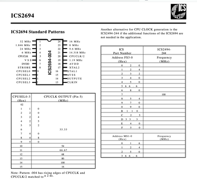

Reply 4 of 9, by Tiido
The ICS branded chip is the clock generator, I see some resistors nearby that most probably are connected to the freq control pins. They are the key to changing speed, how exactly I don't know, hopefully datasheet is available of it and it'll tell exactly how to connect the pins for the needed clock.
Reply 5 of 9, by pico1180
Here is a link to the board
https://theretroweb.com/motherboards/s/dell-d … dx2-5#downloads I believe this one is it.
https://theretroweb.com/motherboards/s/dell-s … ev.-2#downloads this board looks like it as well though.
Here is a better pic of the jumper area. Most of those jumpers are accounted for tho. The DIP switch is for configuring the onboard video. That empty Y1 next to the crystal is interesting I must say.
Reply 6 of 9, by mpe
The 4 pins on lower right side of the clock generator specify CPU frequency (multiplied by 2).
The attachment Screenshot 2023-01-11 at 13.30.58.png is no longer available
So my guess that they are either wired through some jumpers or hardcoded.
Should be easy to find it out.

Reply 7 of 9, by mdog69
The empty Y1 position looks like a space for a larger/taller format crystal installed in the same holes as the crystal installed below it, but with the legs bent 90deg so that the body of the crystal lies parallel to the PCB.
The two pads are not connected and are there to mechanically attach the body of the crystal by soldering if required.
I'd be looking at the function of the W2 and W3 jumpers.
Reply 8 of 9, by pico1180
mdog69 wrote on 2023-01-12, 22:44:
W2 clears CMOS
W3 does :
I/O bus speed select SYSCLK/2 pins 2 & 3 closed
I/O bus speed select SYSCLK/1 pins 1 & 2 closed
Sounds promising, but it wont post when configured to "SYSCLK/1". It will only post when configured to "SYSCLK/2"
