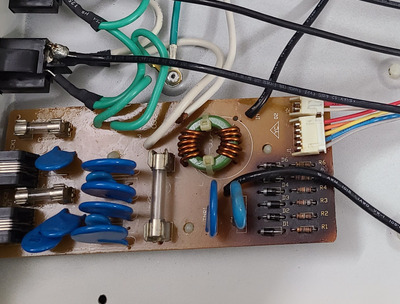

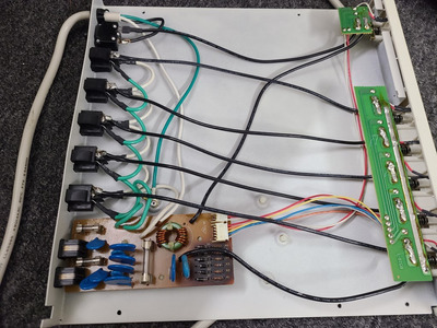

Today, I was doing some tidying up and noticed that the metal panel on the back of the power center looked like it had been pushed in a little, so I figured I should take a look at the insides in case it had been damaged when the person brought it to me. I noticed the buttons had a really nice and satisfying feel to them and the unit was almost entirely metal... seemingly a decent piece of equipment.
Once I got it open, my jaw dropped...
209.94 KiB
1019 views
497.79 KiB
1013 views
There was a big cluster of resistors and diodes where the PCB had been so heat-damaged that it was nearly black. Several of the resistors were actually starting to crumble, and there was a big spot of dark soot on the top panel above this area. I followed some traces and it appears that these resistor+diode pairs connect to the tiny LEDs that indicate which buttons have power. I have no idea what would cause these to get so hot, but the owner had been using this thing for years and it was actually operating when I was at their home office helping them with the PC.

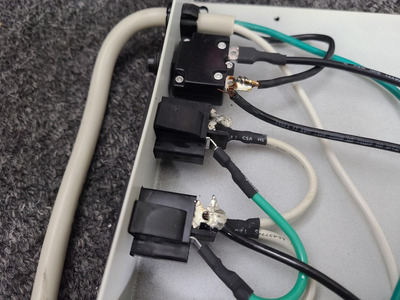

I decided to just harvest a few parts from it and leave the rest for the scrap heap... making sure to avoid anything that might have been damaged or related to the LEDs. Basically, I just took the power cable, circuit breaker and the power switches + plastic caps. While moving things around inside the chassis I noticed that one of the black wires popped loose from the soldered outlet terminals in the back with very very little tension. I found several more terminals that looked solid because they had a big blob of solder, but the wire that went into it was freely spinning or moving around with a blob of solder on the end doing nothing but preventing it from pulling through the hole.
155.25 KiB
1019 views
(black wire that had come loose from second plug, and black wire freely spinning around with blob of solder on the end on the third plug)
So, yeah... you can bet I'll be inspecting the other three power centers that I use. One of them I did inspect 5-6 years ago and it was fine (and probably at least 15 years older than this one), but the other two I have never bothered opening. This is equipment that looks fine on the outside but could be so poorly designed and assembled that it could be a ticking time bomb for your old gear or even worse, a massive fire hazard.

majestyk wrote on 2023-01-14, 14:07:
Connecting multiple ground wires and the metal case with a rivet is probably not allowed in some countries.
Yeah, I can't really comment on the soundness of the overall design because that's just not my area of expertise. There was definitely more than one thing wrong with this unit though, despite it looking solid and well built from the outside.

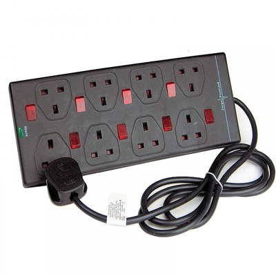

These type of things are also quite common in the UK, but they're significantly more durable and made to much higher standards:
ukdj-surge-protected-8-way-individually-neon-switched-extension-lead-5m-black-p6059-19083_zoom.jpg
93.7 KiB
754 views
You can get them in all kinds of form factors - trailing extension leads like the above are very common, but there are also desk mounted items, towers etc. It is very common to have individual switches on the sockets - all of our mains sockets are also individually switched in the UK. In a previous job I used to run the IT systems for a Computing department in a large UK university; the thought of having electrical equipment like that is absolutely terrifying - one thing I used to have my team do regularly was patrol for international students in our labs who had brought in their own extension cables, chargers etc. The idea of having equipment made to standards (if you can call them standards!) like that plugged in to labs with hundreds of thousands of £ worth of equipment in is crazy.

So the burnt/overheated part with the resistors and diodes, does anyone know exactly what's going on there?
My first guess would be that the voltage being fed in is higher than what was designed for, so the resistors aren't limiting the current to "safe" values...
Reply 8 of 12, by dionb
jmarsh wrote on 2023-01-15, 20:58:
Without seeing the traces I can't be sure, but I think it's even worse...
Normally if you want to turn AC into DC you first use a transformer to get AC voltage near what you want DC, use a bridge rectifier (network of four diodes) to turn the AC into bumpy DC, then add a big cap to smooth that into nice DC. You then use a voltage regulator on the DC to drop it down to exactly the desired voltage, either a linear regulator (which 'burns' off excess power) or a more elegant PWM regulator, with another cap to smooth out the pulses.
Here there's no transformer (that little coil certainly doesn't count as one) but worse: unless there's some interesting wiring underneath, there's no rectifier. Mains VAC is going straight into those rectifier diodes. They are chopping half of it off and the resistor after it is acting as a ghetto regulator to drop it from mains to whatever the LEDs take without blowing them out with too much current. With the imperfect lighting and discoloured resistors I can't exactly figure out their value, or even if they originally would have all been the same. That output in all its pulsing half-sine glory gets fed to the connector and the LEDs. That also means that these diodes and resistors are likely to get rather hot, which over time can cause things to go black.

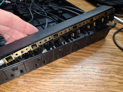

These poor designs is rather common. Even the newest power bars are poorly designed, Contacts made of thin tree-like fingers weak stamped from brass sheet.
Finding quality one is not easy than you think.

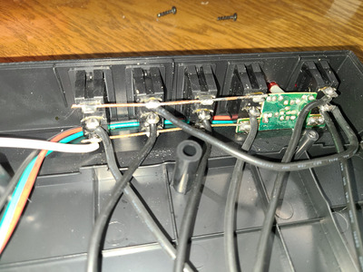

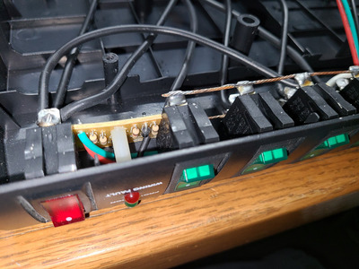

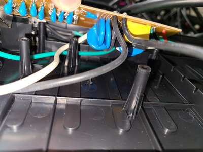

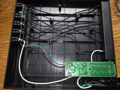

Before getting my MIDI stack hooked back up I disassembled the power center I intended to use for that. It doesn't look like a work of art inside, but thankfully, it looks to be a bit better quality than the other one. At least nothing is burnt, the outlets on the back are assembled similarly to a real surge protector, and it smelled like new electronics inside when I opened it - rather than burnt electronics. It is manufactured for\by National Lighting and seems to still be somewhat easy to find online. Interestingly, despite it's retro-look, it has a website address printed into the plastic on the bottom, so I would guess it is less than 20 years old.

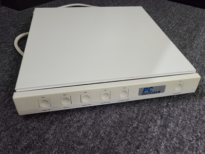

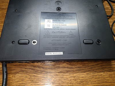

Also, one more thing worth mentioning...
I was a bit surprised when I looked more closely at the big foil label on the "PC Concepts" one I originally posted about. It was playing double duty as a tamper-evident seal and the only date written on it was 1991... which really CAN'T be the date that the thing was manufactured. It had to have been just some arbitrary copyright date, either for the label or for that particular design. It was kept in an office with fluorescent lighting and windows, so the plastic front would definitely have been bleached if it was 30+ years old.

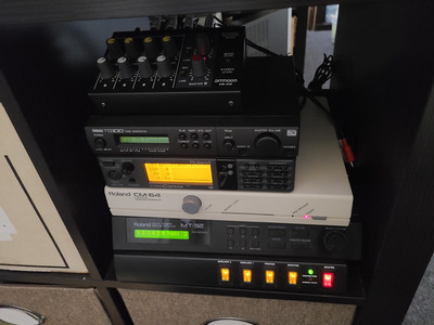

Two more pictures of this power center, and the neat retro-glow the fits so nicely with a MIDI stack.
1.66 MiB
577 views
618.62 KiB
577 views
Each device is connected to a switch. The mixer is switch on with the red Master switch. The rest are switched on in order from right to left, top to bottom. Very satisfying to switch them on this way, and I don't have to reach to the back for the MT-32.
