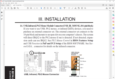

I have a USB PS2 card that slots into the a PCI connector. Is there any chance I can get this to work on my ASUS P97-S under Windows 95. I've scoured the web but no luck. I'm really not that interested in getting USB to work, I just need PS2 for a mouse.

First, what is an "Asus P97-S" ? I can't find any reference to that anywhere, so I presume that there's a typo somewhere. Can you verify and confirm or infirm this ?
a) If that is late generation AT format board (rather than ATX), it likely has a PS/2 compatible pin header on it to which you could connect a female mini DIN connector to have a functional PS/2 port.
EDIT : Perhaps it is an Asus P2L97-S ? EDIT2: That is unlikely as the P2L97-S is ATX and already has a PS/2 mouse port
b ) If your board has onboard USB ports (1.1 or 2.0), you might as well use a USB mouse. There is nothing to be gained from a compatibility or functionality perspective by adding a card with a USB controller and ports and also an integrated USB to Ps/2 converter .
c) Unless your board has a PS/2 mouse emulation over USB option in the BIOS, you will need to use a rather big (conventional memory footprint wise) TSR program to allow the mouse to work in DOS, this will likely be problematic if you intend to run conventional memory hungry programs. Additionally any PS/2 mouse emulation over USB option your BIOS may have will likely only work with your motherboard's integrated USB ports
d) If you intend to only use a mouse under Windows, you will be better off with a native USB mouse, again preferably on one of the motherboard's integrated USB ports

Sorry the board is a Asus SP97-V. It has a USB PS2 Infrared header on board but as I don't have an ATX form card (they don't seem to be a think outside of the US) I thought the USB to PS2 PCI card would be the best option. It's recognise by windows 95 but there doesn't appear to drivers for it.

Why don't you make up a cable and connect the PS2 mouse directly to the USB_IR_MOUSE header?

This is still at best misleading as the SP97 integrated USB ports need an optional header which as op needs to add a PS/2 port he clearly does not have.

The pinouts on those cards and headers can sometimes vary. I have learned the hard way the best way to probe them is with a scope because hooking them up wrong can fry the ps2/usb controller

Please keep in mind that I was explaining/detailing my line of thought prior to OP confirming that there were no USB ports on the board (only headers). That line of thinking only made sense if there were directly usable USB ports on the motherboard, which OP confirmed was not the case in a later post. I also mentioned this in point b) from the very beginning (you only quoted part of it):
That all being said, I think we will likely all agree that since a PS/2 mouse port header is present on the motherboard (which we now know), it makes the most sense to source (and modify, if necessary) a mini DIN connector and use that on a Windows 95 machine.
