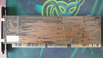

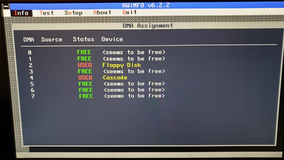

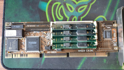

I buy a Tekram DC-680C ide vlb cache card, and i have problem configure it.
At boot i don't see the message : press f2 or f6 to enter configuration
The fdd part is working, can i boot from floppy.
Only video card and this tekram attached to mainboard.

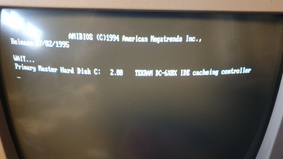

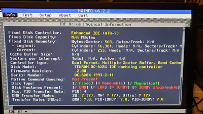

I try with many video card, 2 486 vlb motherboard, try to set up at bios disable bios shadow, enter the hdd type 1
At boot i see registration of tekram.

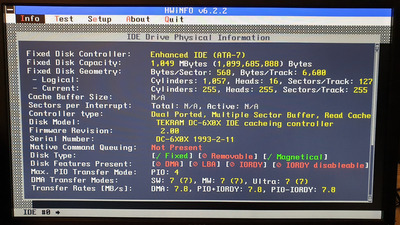

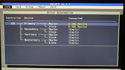

I try run hwinfo, there is existing settings for 2 hdd with tekram, but i try it with one hdd, and the settings isn't mine.
Try without attached hdd, try with 2 attached hdd too.
Try change the 30pin ram from my working 386, without result.
Has anyone helping hint, how can i enter to tekram configuration page to set up my rig?

The Tekram controller answers to the IDE identify command only if it passed its internal POST. As you see two drives recognized, we can immediately conclude that none of the four fatal error conditions apply on your system. Furthermore, the "fast address decode" issue for the VGA card only applies for VGA cards that allow 16-bit BIOS access. Some ISA cards provide 16-bit BIOS access, but as the VGA BIOS is more often shadowed than not in 486 systems, nearly no VL VGA card claims 16-bit cycles in the C000-DFFF address space.
The BIOS on the Tekram controller is accessed from the ISA bus, whereas the IDE ports are accessed through the VL bus. Your issue looks like the communication between the ISA bus connector and the TRM680C is not working properly, maybe a trace is broken. The photo of the back side of your controller shows a scratch, which might be worth investigating. The scratch doesn't look that bad, but I'm not sure no trace is damaged. If you have a meter, you shoud check whether you get continuity to some TRM680C pins from all 20 ISA address pins (A12-A31), the low 8 ISA data pins (A2-A9) and the ISA SMEMR pin (B12). You could also check whether you get something on the ISA bus at C800:0, CC00:0, D000:0, D400:0, D800:0 or DC00:0. If you do, the kind of data you observe might give a clue to the type of the fault. Possibly a tool like CHECKIT or MSD also shows which address ranges in the upper memory area are occupied by ROMs, even if they don't seem to contain valid BIOS extensions.

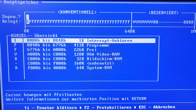

I check it. Sratches isnt problem, no discontinuities.
A12-A31 and B12 is connected to Tekram Chip, A2-A9 is connected to Goldstar Floppy controller.
Here is a photo from checkit:
Reply 11 of 26, by mkarcher
envagyok wrote on 2023-01-19, 08:53:
Also, A31 to B22 is connected to the Goldstar floppy controller, and those connections are obviously OK, as the floppy controller works. Furthermore, A2-A9 is also connected to the Tekram chip. Those traces look fine.
That photo shows that the card does not seem to respond to ROM cycles at any address. The only lines required for the TRM680C to detect ROM requests are A12-A31 (address lines) and B12 (memory read request), and you checked those. Even if one of the data lines (A2-A9) were broken, you should see something in CheckIt. If the design of the DC-680C is similar to the DC-680T (the earlier variant, which I own), there is a small stub ROM integrated into the TRM680C chip, which is enabled under firmware control (for 2.x firmware), whereas 1.x firmware required an external host ROM. The 680C still has the solder positions for a ROM chip and an 8-bit buffer chip near the GoldStar, but as it never shipped with 1.x firmware, these components were not populated.
If the firmware was corrupted, the integrated stub ROM is possibly not enabled, but we know that the firmware works and passes its internal checksum test, because we observed correct behaviour with and without cache RAM, so it is highly unlikely that the firmware is corrupted. So I am out of ideas why your computers do not see the ROM.

Where stored the hdd settings?
Can i delete without entering tekram bios?
I think maybe corrupted some data, and that's the reason. The chs settings read from hwinfo is wrong too, one of hdd had only 0 heads there, that's impossible.

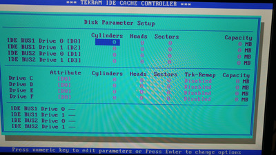

Reply 19 of 26, by envagyok
Thank you, its working.
When i enter to settings, there is every drive empty, i try filled one connected drive's info.
Then restart the pc, run hwinfo, and there again the old drive settings with 2 drive what i photo from first 2 message this thread.
I try run again setup, i see again every drive empty 🙁 (but with hwinfo there is a 2 old drive sewttings)
Sadly not store the settings, and remain the old settings, and no see f2/f6 login screen at start.
@mkarcher
"The EEPROM is only accessible from the 80286 processor on the Tekram card. So you would need to send a "delete the EEPROM" command to the Tekram firmware. There is no simple delete command, but there is an EEPROM write command. I could tell you how to write a program that reprograms the EEPROM with contents with a bad checksum, so the Controller will fall back to a valid default configuration"
its not to difficult?
