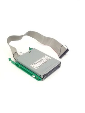

I ordered a new PC case for my retro Pentium 4 system. It's an Inwin IW-J508TA case, nice classic looking but very weird drive holes/bays.
The floppy drive fits its bay but the screw holes don't match at all. Or perhaps I'm just too tired and missing something?
Tried two different floppy drive brands, didn't help.
So, any clue?
Reply 1 of 13, by Repo Man11
I can't be sure from the photos, but my suspicion is that case uses spring loaded drive rails - hopefully you received them with the case. Something like these:

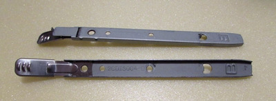

Reply 2 of 13, by deksar
Attached image, I received too many these ones, tried to fit them to the fdd, but I couldn't.. I don't even know if these would help.

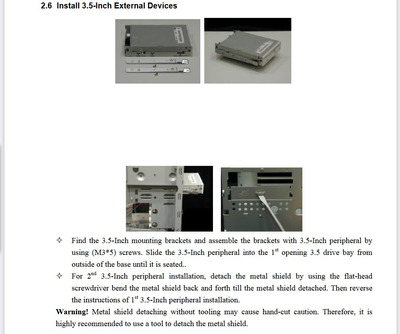

Reply 3 of 13, by PC Hoarder Patrol
deksar wrote on 2023-01-19, 19:39:
They do seem to be the correct rails...

Reply 4 of 13, by deksar
Thanks for the image.
It seems the drive doesn't really fit in that way?
When it has no rails mounted, it fits the bay completely, without any space left..
Reply 6 of 13, by deksar
red-ray wrote on 2023-01-19, 22:04:
I suspect you need to remove the case front cover
That was it! Thanks a lot, red-ray!

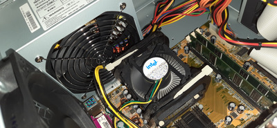

This PC case came with a PSU called Power Man, model: ip-p350gj2-0
It seems its fan doesn't spin, is that normal (thinking perhaps it'd run when it got a higher load) or it's simply a defect PSU? (As this is actually a very old case (new old stock)
I don't really want to learn the answer after a voice of explosion here..😀 Wanted to ask here.
Reply 8 of 13, by red-ray
deksar wrote on 2023-01-19, 22:58:
There are modern (< 10 years old?) PSUs that have Zero RPM mode, but my guess is that the fan and/or PSU is faulty. When was the PSU manufactured?
Were it my PSU I would open it up and check that the fan spins when I connected 12 volts to it and if the PSU is > 15 years old bin it and get a modern PSU.
Reply 9 of 13, by deksar
red-ray wrote on 2023-01-19, 23:29:
No idea, it doesn't tell nowhere on it..
Reply 11 of 13, by Ryccardo
Wild ass-guess from the serial number: 2006
But as you can see 50 seconds into https://www.youtube.com/watch?v=q129AbHL0ek the fan seems supposed to spin all the time...

Reply 13 of 13, by PC Hoarder Patrol
deksar wrote on 2023-01-21, 17:39:
PC Hoarder Patrol wrote on 2023-01-19, 20:29:
@PC Hoarder Patrol
Could you please kindly upload harddisk mounting part of the same manual? Thank you!
No problem (included the full manual for reference)
