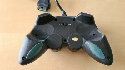

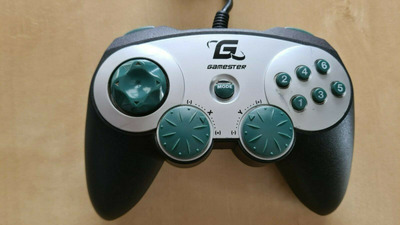

Hi all, I picked this up yesterday:
https://youtu.be/2y5Zq1MLeQQ
It's a retro tilt controller that i'm guessing is from the year 2000, but it's got a switch to toggle between DOS/WIN.
After i filmed that video i connected it to an XP computer, but there i get no response and the PC doesn't react to me attaching the controller, even though the DOS computer does see the tilt as a 4button gamepad/joystick.---------
Being a gamester branded controller i can't find any info on it in the 3 days of searching i've spent and i'd like to see how the other inputs work...
I can't find any drivers for it but maybe there is a miniscule chance that it might work with the drivers for the gravis tilt, sidewinder freestyle pro, wingman tilt or the saitek p2000? any other suggestions?

Reply 4 of 8, by Horun
My guess is that DOS mode is Analog mode and Win mode is Digital where the "tilt" effect would work (like the Freestyle)
Reply 5 of 8, by Vic Zarratt
Horun wrote on 2023-01-20, 02:13:
The tilt works in DOS as well, it seems that any DOS program will "see" it as a 4button joystick, but it doesn't see the d-pad or the dials, even if i hit the MODE button or the dos/win switch
I manage a pot-pourri of video matter...
Reply 6 of 8, by BitWrangler
A lot of DOS stuff is only looking for 2 axes and 2 buttons, ocassionally 4 buttons, was like that with my wingman with throttle, hat switch, extra buttons, it only got that support in later DOS games.
Reply 7 of 8, by Horun
Vic Zarratt wrote on 2023-01-20, 02:42:
Seeing "tilt"action as a 4 button joystick is not same as true Tilt where it seemlessly acts like a joystick (not some 4 button thingy), I have a Gravis and MS pad and the true tilt are not DOS compatible.
The dials should be for DOS calibration for centering...Just my observation....
Reply 8 of 8, by Vic Zarratt
The dials do absolutely nothing, if you've seen the video i linked in the OP then you can see me struggling to get the crosshair to center properly.
