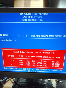

I have a question about a bios hdd config table when `auto detect`

Only 1st and or second setting would be the best option here. Maybe the last one too.
The harddisk 8,4 GB is the latest one that could handle a pentium motherboard to the max setting.. (because most biosses cant handle over 8,4 GB (because of the known bios limit)
The best setting that will match the sticker / label on the drive would be 8455MB / 16383 Cyls / 16 heads / 63 sec (in normal setting)
What benefit would i be getting if i choose `LBA or the Large setting?
See i some speed inprovements with going with LBA or Large? Because HDD can be setup in each way.

There are some operating systems like DOS that do not have access to cylinders over 1023.
So I'd recommend to use LBA or AUTO for maximum compatiblity.

So LBA is only used for lowering the Cylinder count?
Whats the max side if hdd that still can use that LBA setting trick (limited to 1024 cylinders)

Depending on your BIOS you may face a limit at 32 GB or 64 GB.
BIOS may hang at startup then.
At 128 / 137 GB its size may be capped, if your BIOS does not have 48-bit LBA support.
All modern HDDs use LBA.
This on your screenshot is just the CHS translation for legacy systems like DOS.

LBA is a type of "translation" of CHS. If you set 1023c x 255h x 63s x 512k/sector = 8,414,461,440 or 8.41G (or as reported by DOS ~ 8.2G)

My experience would be that if you set normal, DOS will only see ~500ish MB, if you set large it will only see ~2000ish MB (It was an intermediate standard until full LBA, for using disks up to 2G AFAICR) so you want to set it to the recommended LBA to use most of the disk, in partitions as large as the OS in use will allow, but in this case might be a small handful of MB short.

Normal means CHS access (int13) is passed through to the disk, with the 504 MB limit for IDE disks due to the famous lowest maximum C/H/S definitions in IDE and int13
Large means CHS access goes through some arbitrary kind of conversion usually but not necessarily based on bit shifts goes on, this has various implementations (and so is not guaranteed compatible across PCs or, for that matter, int13 implementations such as if you switched to the XTIDE option rom), some break at around 2 GB, some can go all the way to 8 but are less compatible because of MS's 256 heads bug (there may be a "Large disk access mode = DOS or Other" option to limit them to 255 wasting some capacity, or a functional equivalent to this option may be always on)
LBA means CHS access is converted to a sector number and LBA(28) mode is used instead, this is generally the best option - if your disk supports LBA that is!
Of course, all of these stop at the int13 maximum of 1024/256/63 and none of this applies to "int13x", which is proper LBA passthrough...
...So, what's up with that Normal numbers if I said int13 is limited to 1024/256/63?
Well, something does really apply even to true LBA mode - the BIOS still needs to know the hardware-compatible CHS capacity for the "extended disk parameter table", but then who knows what it will declare in int13 for capacity - maybe 504MB (1024/16/63), maybe something invalid, who knows? 😁

Impossible - or rather, guaranteed not to allow int13 access over the 8 GB limit; might still be valuable if the original firmware has a lower maximum for LBA/Large or outright freezes with an oversize disk!

You will need a BIOS from 1998 or later to find the Int 13h extensions nessary to break the 8GB limit. The latest AB-PT5 BIOS on TRW is from 04/18/96, so I'm sure this BIOS is limited to 8GiB.

Already find out that the AB-PT5 wont getting any further then 8GiB.. Because i tried a 20GiB disk on the onboard controller.. And it only showed about 8455 Mb of that disk.
