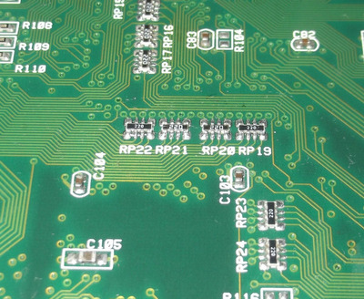

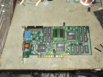

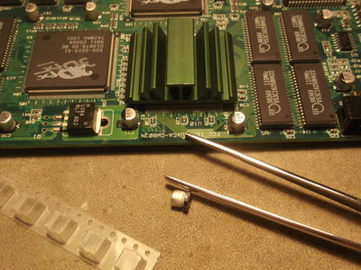

Gainward Dragon 3000 (Voodoo 2)
-Has some missing components. Two of the cool anodized green heatsink are not on TMU0 and the FBI chip. C21 and c54 capacitors have been taken off. The solder pads look too clean. This could not have been done by physical damage.
I wonder if the card could work without these.
Also I suspect that RP22, RP19, RP23,RP24 resistor networks are not orignal. Othervise resistance values are measured good. So someone was trying to repair the card before.

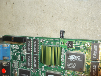

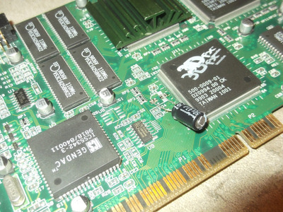

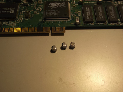

Anyway. My bodge fix until I source the right value smd capacitors:

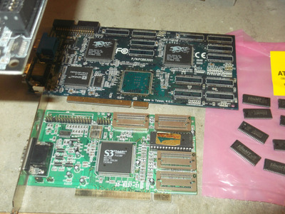

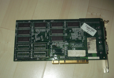

Procomp G111 Voodoo 2
-Another experiment or was it used for parts? Half of the FBI memory is gone. No damaged pads. The card works though.

Would be great to just add the missing ram and get a fully working card.

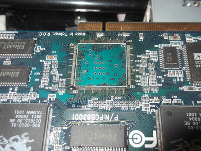

Provideo PV830 Voodoo 2
-Lots of missing passive components, bracket and the FBI is gone too. At least the pads are unharmed. Looks like this card was cannibalised for parts.

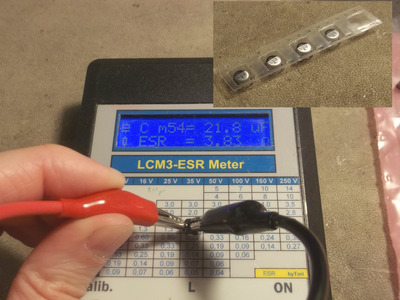

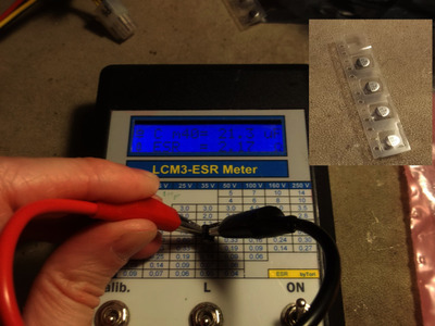

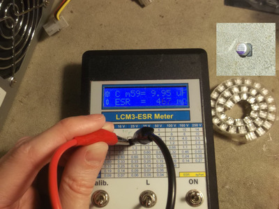

I was looking for replacement capacitors for the Gainward card. This card has aluminum can 22uF 16V electrolytic capacitors where other brands used non polarized ceramic smd caps.
Took off one to see it's capacitance and esr values after 25 years. They don't seem to be worn.
589.24 KiB
886 views

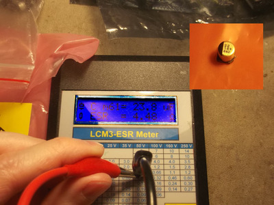

What I have in the same size are some chineesium VT series that have varying esr.
565.75 KiB
886 views
442.77 KiB
886 views
Or some polymer that has lower capacitance and might have unnecessarily low esr.
572.7 KiB
886 views
I'd like to have the card look as authentic as possible so I'll go with the 22uf VT caps probably.
Reply 3 of 11, by DAVE86
The Gainward after replacing the capacitors.
502.1 KiB
834 views
691.29 KiB
834 views
It still works, so it's a win.

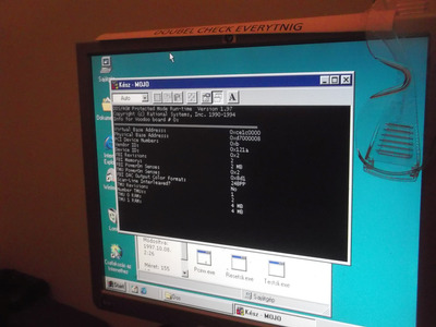

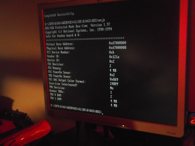

Placed new 512k rams on the Procomp.
731.24 KiB
834 views
189.55 KiB
834 views

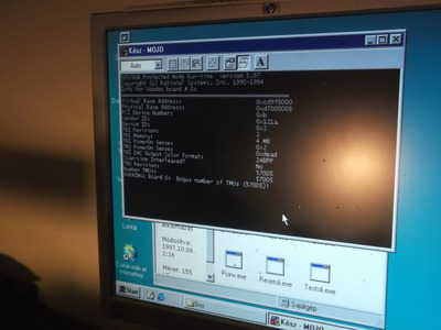

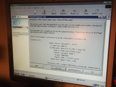

Under DOS Mojo reports 4MB of FBI memory and all seem ok. In Windows there are issues with TMUs. Opening display properties hangs the system entirely.
333.22 KiB
834 views
I'm curious what could be wrong. The card worked fine with only 2MB of FBI memory. I suspect that someone removed that 4 memory chips so that card would work thought somewhat compromied.

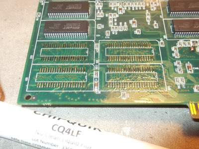

Reply 7 of 11, by DAVE86
Though I used new 512KB SOJ40 chips on the Gainward. I started to dissasamble the PV830 card since I wanted to test the rams on it.
I used a S3 Trio64V+ vga that has sockets for ram. I inspected and cleaned the chips and the sockets too. I used 3M Novec degreaser and flux remover.
782.76 KiB
702 views
The results were always the same. Some chips test good and others bad. This could have been caused by heat that previously damaged them. I know I couldn't have damaged them 😁
So it occurs that with the bad ram the image is corrupted or has artifacts or the S3 can't even address them and the pc just fails during POST.
Swapping between bank 0 and 1 or pairing good chips with bad ones on the card changes the pattern of the corruption but bad chips always mess up the image obviously.

I'd try to fix that bodge cap to the board somehow, perhaps some hot glue would do the trick. If it catches something when you handle the card, chances are that you rip the cap with copper traces off the PCB by accident as it is now 😀

I have replaced the bodged capacitors with proper smd ones here.
