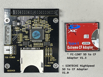

Sometimes these Sinitechi clones have different firmware. It would be interesting to see if the SD-IDE devices that acted differently had different firmware.
If you use a diagnostic tool that can generate an ATA report, you can see a lot of info. I usually do the text report from speedsys, but HWinfo and many other diagnostic tools can see the info
Here is what I see for two of mine when connected to an ATA-6 Nforce2 IDE controller:
IDE1 Master <ATA-7>  SINTECHI HighSpeed SD to CF Adapter V1.0
* Firmware Revision : Rev 1.2
* Maximum Transfer Mode : PIO 4, DMA 2, UDMA 5 (ATA-100)
* Selected DMA Transfer Mode : UDMA 5
* Cache Buffer Size : 8 KB
IDE1 Master <ATA-7>  FC-1307 SD to CF Adapter V1.3
* Firmware Revision : Rev 1.3
I have trouble getting these devices to work with computers with ATA-2 controllers (PIO4, DMA2), but they have worked fine with newer (>= ATA-3) & older controllers ( <=ATA-1). Could have just been the BIOS though.
