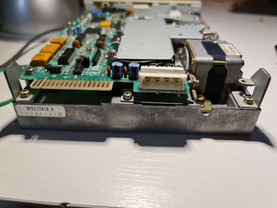

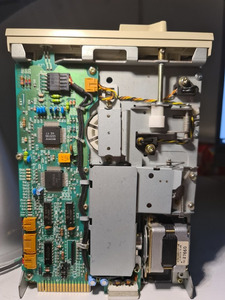

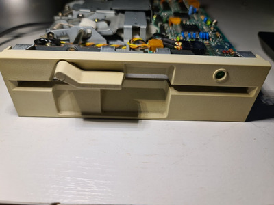

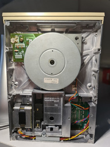

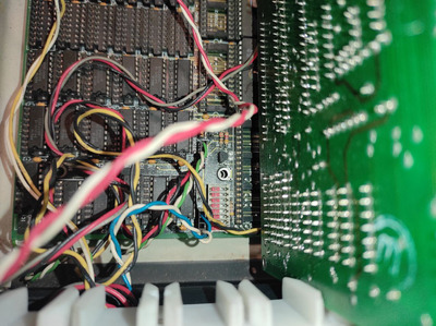

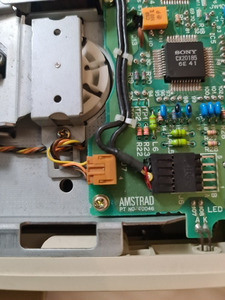

Hello, I am desperately looking for a 5.25 drive, that seem impossible to find for a reasonable price noways.
I found one but i'm unsure if it will be compatible with a classic 286-386 computer.
Those are the info I found: The marking is DFC222A16A - on the pcb there is an inscription Amstrad.
Here are some pictures:
Am I buying something worthless?
Reply 1 of 66, by BitWrangler
It's 360kb low density, but a working one will work provided you get the jumper settings correct, Amstrads often used "no twist" floppy cables, where the drive ID was individually set, vs the non-standard PC standard where everything is set to second drive ID, be that 1 or 2 (some labelled 0,1,2,3, some labelled 1,2,3,4) and it's sorted out by the cable twist.
Edit: as Errius said Double Density, I keep forgetting the existance of SD single density, which was mainly a thing for CP/M systems, Apple IIs etc. My brain goes Low/High, being the lowest and highest common on PCs.
Reply 3 of 66, by Errius
That will be Sankyo with Amstrad branding. I have a pair of DFE222A10-A drives which I guess must be similar spec.
Is this too much voodoo?

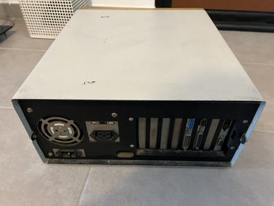

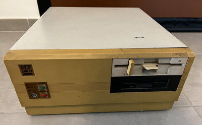

A bit off topic, but I found a computer labelled MP 286H, clearly a 286, with a 5.25 floppy drive, is it possible that this one will be able to read 1,2mb 5.25 disks?
I'm really unaware of 5.25 drives (or disks) since due to my age my first pc was a 386 with only a 3.5 floppy drive.
This is the pc:
203.85 KiB
1159 views
Reply 9 of 66, by Nemo1985
Errius wrote on 2023-01-29, 02:16:
A 286 will almost certainly have a high density (1.2 MB) drive, but you should check with the seller to make sure.
I doubt the seller is willing to share any info, he is selling the pc as it is...
The price is the same as if I would buy a 5.25 floppy drive only, though...
I hope it won't be a bad deal, I noticed that the floppy drive has a cardboard inside the drive, so it should have been kept properly?
Reply 10 of 66, by Errius
Yes the cardboard is there to stop the heads banging into each other when the machine is moved. It's a good sign, but you can never be sure with things like this.
Good luck with the purchase.

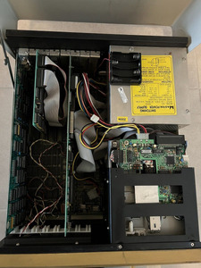

Bump, I got the pc, how should I proceed?
Check if battery leaked (but I doubt I noticed it had a 3 battery holder instead of the barrel leaking battery, also how can I check the psu in case it went bad?
Should I connect it with just an hard drive connected? Maybe one I can sacrifice? Or can I use a floppy 3 1/2 drive?
Picture:
    272.71 KiB
    1088 views
Reply 12 of 66, by Errius
When I receive a computer like this, the first thing I do is completely disassemble it while carefully photographing everything. Clean dust, check for damage (burned components, etc). Also look inside the PSU. Blow some canned air over everything.
Then partially reassemble it. Just motherboard, PSU and video card. If it powers on OK, reconnect the other things.

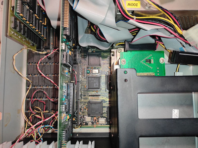

Reply 13 of 66, by Nemo1985
I measured the value from a molex cable (after disconnecting the 5.25 floppy drive (the thing I care most):
5v : v5,05
12v: v11,97
The inside was moderately clean already but I got worried from the dimension of the cards installed.
There is a more pressing problem now.
I can't test the pc because it doesn't has a vga compatible video card?
211.53 KiB
1031 views
Any suggestion? Try to plug an isa card?
Reply 14 of 66, by BitWrangler
You might have CGA composite there. However, that's not super easy to deal with in Europe, I synched it before on monochrome security monitors that had a lot of vertical hold adjustment. Might get mono synched on Amiga, CPC464 or Atari monitors with vertical hold fiddling, or if you have a TV model that was sold worldwide, luck out and have it recognise the NTSC color encoding.
