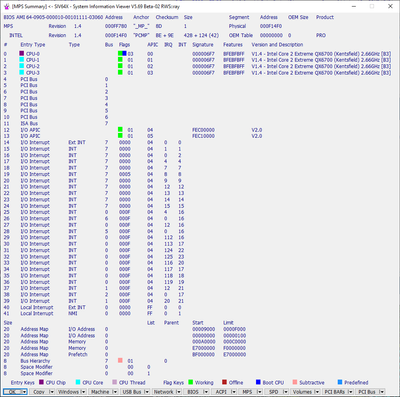

First post, by red-ray
I have two Pentium 4 systems, a Gigabyte 8IPE775P + Pentium 4 660 (Prescott 2M) @ 3.60GHz and a MSI MS-6742 (865P Neo) + Pentium 4 (Northwood) @ 2.80GHz and in both cases NT4 only sees one CPU, but W2K and later see two. Looking further I spotted https://www.youtube.com/watch?v=pOvO2Pm8YJ4 and again NT4 only sees one CPU.
Does NT4 ever see both CPUs and if so for which motherboard?
Looking at the MPS 1.4 information both my systems only report one CPU which is why I guess NT4 only comes up with one CPU so if any systems have both CPUs I would be interested to know what their MPS tables report.

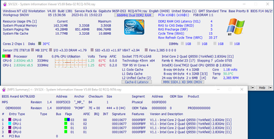

Reply 8 of 22, by red-ray
Azarien wrote on 2023-01-29, 23:31:
My NT4 virtual machine (VMware Workstation 17 Player) recognizes 2 (but not 4) CPUs
By default NT4 Workstation is limited to 2 CPUs, what happens with NT4 Server? There are also patches to circumvent the 2 CPU limit, but I have never used them.
How many CPUs does the MPS 1.4 table report?

Reply 10 of 22, by red-ray
Azarien wrote on 2023-01-30, 00:25:
Where can I check that MPS table?
Menu->Hardware->BIOS Tables->MPS
file.php?id=156192

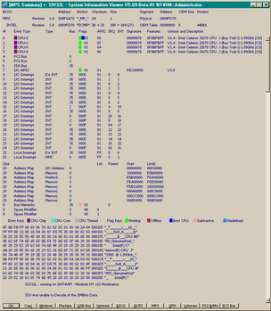

Reply 11 of 22, by Azarien
It seems that it can see 4 cores, and only 2 work because NT4 Workstation supports only 2.
But it's interesting that the CPU is recognized as J2670 which doesn't even seem to exist? It's J1900 in reality.
34.75 KiB
1070 views
Reply 12 of 22, by red-ray
Azarien wrote on 2023-01-30, 01:33:
Thank you for mentioning this and I would like to try and adjust it, but I need more information. Please do Menu->File->Save Local and post the generated .TXT + .DMI files. The .DMI is a save of the SMBIOS which may also enable me to fix the decode issue.
I assume you are using a VM and wonder if this is why SIV reports 4 physical chips rather than 1 + 3 cores. It would be helpful to also get the two SIV save files from the system that hosts the VM.

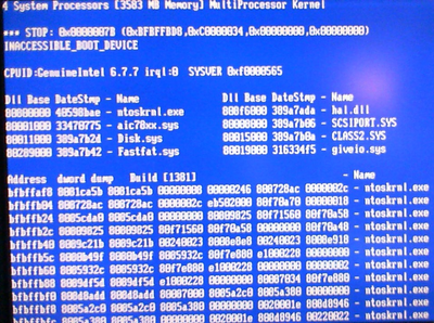

I felt I would try NT V4.00 Server on a Quad Core system, but when I booted the install CD it got half way through loading then the system did a spontaneous reboot 🙁
I then tried copying the NT V4.00 SP6 Workstation installation from my MSI MS-6742 (865P Neo) system and that booted, but as expected only two CPUs showed up.
Next I copied NT V4.00 SP6 Terminal Sever installation from my Intel MS440GX, that started boot with four CPUs, but then failed as its expecting a SCSI rather than SATA disk. The good news if that it detected 4 CPUs 😀

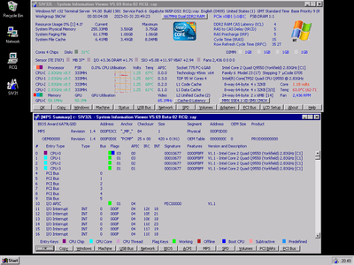

Reply 14 of 22, by red-ray
I don't like to be beaten so I installed NT 4 Terminal Server on my MSI MS-6742 (865P Neo) then copied the installation across the network!
file.php?id=156296
I was initially surprised how hot the CPUs were, but then realised it's down to them running at full speed all time time.
