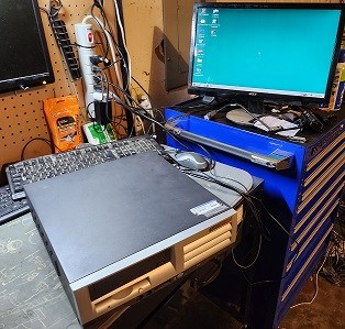

Reply 8 of 14, by tomcattech
OK,
System is up and running and all Win98 drivers are in except for the USB 2.o.... I got the 2.0 running using the common nusb33e driver.
(Still shows an issue in Device Manager but works like a charm...)
Ordered a Radeon 9200 SE half height card and should have it here in a few days.
I'm not expecting performance like my "ultimate" 98 rig, but I can already tell it is going to be much easier in the workspace.
    38.82 KiB
    607 views

Yea,
Not quite sure why it is generating the issue in Device Manager..... but all of the USB ports work like a charm with the generic driver. (USB thumb drives and everything else)
Maybe it's looking for a specific 2.0 driver but I bet there never was one for this particular unit as from what I can tell they were either all XP or Win 2000.
Found some old literature on the model and it states that Windows 98\ME was "supported", but that was it.
Once I get all the hardware where I want it I may get froggy and do a deep dive to fix it.
Right now it is all pulled apart as I'm doing a deep clean and getting ready to swap a P4 2.8 in it.
I also said what the heck and pulled the trigger on a half height Radeon 9550.
I've got to hand it to old Compaq, they did a damn fine job of designing the SFF case regarding ease of maintenance.
The only gripe I have is the "paper" air guide going from the fan to the cpu cooler. Really, they couldn't spring 5 more cents from Taiwan\China for a plastic shield at least?
Anyone out there with a 3D printer and extra time on their hands? 🤣
Anyway, once I get done with everything I'll post a pic of it in its new home.

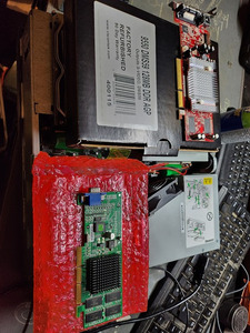

OK so new update\issue:
The Radeon 9550 is not playing well at all with the unit.
When installed it will power on and then nothing..... no post beep.... no beep codes.... no video.
I know it isn't the motherboard because the old GeForce2 MX works just fine.
The Radeon card shows as a "universal 1.5v AGP 3.0" card and is obviously keyed correctly.
The motherboard has an AGP 1.5v 2.0 slot, and the card "should" be backward compatible.
I'm wondering if the anemic power supply is just refusing to cooperate here.
Any opinions?
    145.82 KiB
    450 views
Reply 12 of 14, by tomcattech
UPDATE:
Resolved the Radeon 9550 issue.
For some reason it HATED the DMS-59 to VGA adapter I used.
What would make it not even boot is weird to me.
I put on a DMS-59 to dual VGA splitter and it came right up.... interesting.
Everything up and running except for the CPU upgrade.
I've tried a few games on it and it is flawless as a Win98 gamer, so two thumbs up if anyone wants to try it!

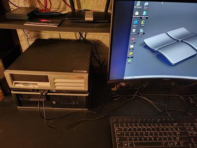

Here's a pic of it right above the XP Small Form Factor PC.... (Both HP\Compaq units)
    168.59 KiB
    410 views

Servicing a fleet of these only complaint I had was the notch thingy that stops the flip up shelf the drives screw onto from falling back down would sometime need a something like a knife blade screwdriver to help it unlock but honestly they were a dream to work on. unlike Dell's and even Compaq's own Presario range where sometimes you had to remove HDD's just to add a stick of RAM.
They do stack nice, shame you can't use generic PSU's which will be what kills mine off one day I suspect but you can't have everything.
Your 2 PC's still takes up less then my XP rig. Now all you need a DOS based SFF right 😉 Sadly HP/Compaq wont be much help here. Think all the SFF's dropped ISA. You do have the DeskPro 2000 or 4000 LPX PC's... I'll help you spend you money 😜
