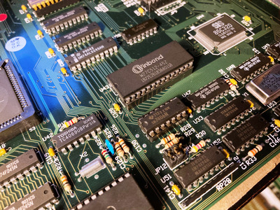

I recently bought an old full-AT 386 mainboard (SIS "rabbit" chipset) in non-working condition.
1.12 MiB
1009 views
Some components like AT-power connector and keyboard connector were missing. After replacing the missing parts and cleaning everything this is what I found out:
- The two tantalum capacitors near the PSU connector in the -5V and -12V lines were shorted so I replaced all 4 tantalums there by 25V types.
- The manufacturer is "Modula Tech Inc.", it has the typical "MT / QC / OK" sticker and when I swapped the BIOS chip in another mainboard with the same SIS chipset it showed the ID "1266" in the AMI BIOS string.
- 4 traces at the corner of the CPU socket were interrupted, someone must have slipped a screwdriver when removing the CPU. I repaired all traces carefully.
- several contacts of the (16) SIMM sockets were/are corroded and worn out, so I replaced the first 4 sockets for a start.
- The 8 cache chips are missing (8Kx8), but the two TAG chips are still there (16Kx4).
- I could not find any info about the model number nor about the jumpering. There are nine jumpers in total on this board.
- When the mainboard starts, you can see it go through numerous POST codes, before it finally stops at "3C".
Video gets never enabled (tried 3 different ISA cards) and the speaker NEVER makes any sound, no memory test click sound, not the slightest click when turning power on, nothing.
I tried different SIMM sets in different banks (9-chip and 3-chip, 1 MB, 256K and 4MB), all possible jumper settings, with and without battery, replaced the (socketed) peripheral controller "82C206", tried with cache populated and without, checked for interrupted traces very carefully, but at the moment I´m running out of ideas.
The missing speaker sound and video seem th be the key...

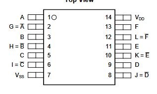

On the ISA bus slots "Reset-DRV" pins are at 5V all the time. Just wondering where this signal is coming from?...
-> It´s coming from Hex-Inverter U46 (SN7406N) pin 12 :
11.32 KiB
876 views
I probed the inputs and outputs with my scope:
Pin 13 - 5V (connected to Pin 2)
Pin 12 - 5V
Pin 11 - 5V
Pin 10 - 3.5V pulsating once per second
Pin 9 - 5V
Pin 8 - 5V (connected to Pin 5)
Pin 6 - 3.5V pulsating once per second
Pin 5 - 5V
Pin 4 - 5V (The speaker is connected to Pin 4)
Pin 3 - 0V
Pin 2 - 5V
Pin 1 - 0V
The ISA reset line is pulled up with 4.7KOhm (resistor array) but for whatever reason it´s not pulled down by the inverter output L=|F when F is high.
When I ground Pin 12 the "rst" LED on the POST card goes out (of course).

Reply 6 of 29, by Deunan
majestyk wrote on 2023-02-03, 08:57:
ISA reset is connected to chipset but on earlier mobos it is often routed via some OC gate like the 7406 you have there. This is because ISA cards can drive this pin low too (that's very rarely used like that). So OC or OD output plus pull-up resistor is correct. And BTW most ISA cards will not work without correct reset pulse, or if the signal is asserted at all times.
I might have misunderstood your earlier comment about the reset LED on the POST card - are you saying it is not changing state when reset button is pressed (or briefly on power-up)? If so, that's definitely a problem that needs to be solved. The gate in '06 is between 12 and 13, and if you see a pulse at 12 but not at 13 the '06 is busted. In fact I already suspect it right now because your voltages are wrong, it's a negation so with 5V input it should have ~0V output but it's always nice to have two things point to a problem, less chance of making mistake when measuring or writing things down.
I'd say desolder and replace the '06. They do die, one of the reason of using a separate gate is to protect the chipset ouput from bad ISA cards that have some lines shorted to VCC or GND. If you don't have spare on hand you can easily emulate one gate with small signal NPN transistor (plus say a 470 om resistor to limit the base current). Reset is not timing critical at all, any common NPN transistor will work.
Reply 8 of 29, by Deunan
majestyk wrote on 2023-02-03, 11:21:
Oops, in fact it´s a 7406N (4069BUP is nearby and I read the wrong chip).
But it´s a HEX-Inverter anyway. I do have some TC4069BUP on stock - do you think I can use one of those?
Pinout is the same but 7406 has OC (open collector) outputs, and 4069 has push-pull outputs. It might just seem to work for a while until the output of the 4069 gets damaged when it's trying to output H and something else drives L on that signal (or, worse, some other, more important chip gets it output busted). So no, if you need a temporary fix to continue testing use a single NPN transistor:
pin 13 -> resistor -> NPN base
pin 12 -> NPN collector
GND (pin 7 will do) -> NPN emitter
Resistor is not critical, 100 ohm to 4k7 will probably work fine, 470-1000 ohm is preferred.
Also, the 4069 is CMOS and low drive part, not suitable to be driving multiple TTL inputs on ISA cards. The usual role of 4069 on these older mobos is a low power oscillator circuit for the 32kHz crystal (plus a gate or two might be used for some other purposes like combining reset signal from PWR_GOOD input with something else, but not as a final driver).
EDIT: To make this clear, the transistor fix explained above can be safely added to the mobo with the 7406 in place. No need to desolder it or isolate the busted gate. In fact it would work just as well if the gate was operational, that's the benfit of OC outputs on 7406.

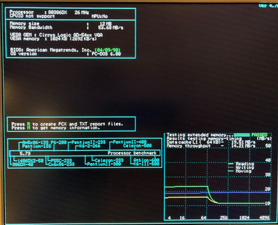

O.k., everything´s fine now.
I tried the BIOS of the Chaintech 325S (April 9th 1990) and managed to enter BIOS once so I could configure everything. Then I connected a floppy drive and populated 12MB RAM and 8 DIL 8Kx8 cache chips.
1.05 MiB
782 views
1.21 MiB
782 views
731.54 KiB
782 views
Phew, this wasn´t one of the easy ones, thanks for the help and advice!!

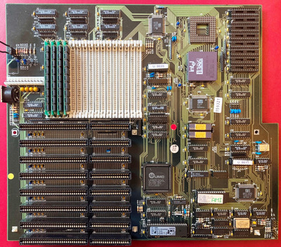

Reply 17 of 29, by majestyk
This one supports 32 MB:
Troublesome mystery 386 "rabbit" mainboard
I still havent managed to get 256K cache working though...
In the SIS datasheets it says this chipset sepports 16 MB.
Maybe I will give the ASUS BIOS a try.

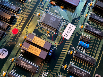

The "not being able to enter Setup" error was back with a vengeance this morning accompanied by additional strange effects like beeps and hissing from the speaker during POST.
The situation improved, when "JP8" was being pushed to the side during POST. So I reflowed the nearby 82C310 chip suspecting some deterioreted solderings there. But this didn´t help.
A further examination revealed 4 damaged traces between this chip and the TAG chips. There were several infinitesimal small dots and cuts hardly visible even under a good magnifying glass. Not the usual visible cuts and scratches.
I had to repair all 4 of the traces with wires to (finally!?) restore full function.
