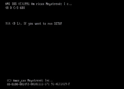

I just managed to rescue a PC and CRT from a local guy's trash trailer. It's a no-name 386SX-16 with 2Mb on board (room for 2 more, it looks like) and 4 empty SIPP sockets. The chipset all seems to be CHIPs branded, but I can't find a motherboard part number on it. There might be one on the bottom, but I won't know that until I pull it fully apart to snip off the old Varta. The BIOS is AMI from 1989 (ENSX-0000-030389-K8).
Included are an ATI audio card, seems to be a Stereo F/X, from what I can tell - a 16-bit WD90C00 based VGA card and a combo hard disk/floppy/multi-i/o card.
It should be noted I haven't had any truly old hardware in my possession for a long while, so I'm forced to wait for an AT keyboard adapter to show up in the mail before I can really do anything with it. I also don't have the original (or any other) IDE hard disk.
I do have a couple of CF card/IDE adapters. One runs in my gateway P120 and a spare that includes jumpers for voltage options, master/slave, etc.
I connected both adapters, one at a time. The less feature-rich one from my working Pentium prevents the system from POSTing. No video displays, no beeps. The other will POST and boot, but when running at 16Mhz, characters are missing from the display. So instead of saying American Megatrends Inc, it'll look more like "Am ric n M atr nds I c" or something similar. This continues into DOS - sometimes the system will continue to boot, sometimes it will lock and beep, sometimes it won't even get the 2Mb correct at POST.
If you run at 8Mhz, it POSTs every time, boots every time, no weird character corruption. https://imgur.com/a/YtJ4nzW
We all know the 386SX is an unholy abomination when it comes to (lack of) performance so I'd really prefer to run it at it's full scorching hot 16Mhz.
I've got an SD to IDE adapter on order (I'll test with it just to see what it does) but I figure it'll be a week or so before I start seeing any parts trickle in to try and make this thing work.
Anyone seen something like this before? Unfortunately I don't have any other cards, video, controller, otherwise I swap and test with.
Reply 1 of 53, by Jo22
Hi there! It seems to be a timing issue.
Some component has trouble keeping up with the rest.
You can try adding waitstates or slow down ISA bus a bit.
Maybe that helps. At least for troubleshooting..
Also, how fast are the SIMM modules? How many ns?
For a fast AT, 70ns or less are recommended.
Roughly, I mean. I'm no expert here. FPM RAM?! EDO RAM?!
Tip: You can have a quick system even if the clock rate is a bit lower.
Instead of running things at high speed, try removing the bottlenecks or reduce overhead.
If your 386SX runs at 14 or 12 MHz, but you manage to have a little cache, or manage to run at 0 waistates,
the end result might be smoother than a fast, but stuttering system.
Good luck. 🙂🤞
PS: CheckIt! has a diagnostic function for motherboard and memory, among other things.
Please try running them, if you can. Maybe that narrows down the issue a bit.
PS: IDE controllers in the 486 days were usually merely IDE host adapters.
They had no intelligence. All they did was attaching IDE hard disks to the ISA bus.
Your CF card gets the ISA bus timing directly, thus. If you overclock/underclock ISA, it has a direct effect on the CF card.
Some cards perhaps have trouble with speeds they consider non-standard.
PS: Size of the motherboard or signal reflections due to the way the PCB traces are layed out (say hard 45° or 90° edges) are also a factor.
Because they have an effect to noise level.
Traces too long work like antennas and can get in resonance if the operation frequency matches by accident (not so good).
Anyway, this is a topic someone could dedicate a whole book about.
I just mention it here, to give an idea that there are some more, possibly unknown, factors. So don't question your sanity.

Reply 4 of 53, by Deunan
elvovirto wrote on 2023-02-12, 02:58:
I have a 286 mobo that does this, but not with all VGA cards. Some work better then others, and also much depends on which slot VGA card is in. The one next to '245 buffer chip (closest to keyboard connector on this mobo) works best.
It could be one of the driver chips being weak but I think it's due to timing on newer, faster ISA cards and lack of line terminating resistors that 386+ mobo do have on ISA slots. Curiously some manuals do say to install the graphics card in either the first or the last slot.

Reply 6 of 53, by rasz_pl
Not the first case of modern IDE drive causing graphical glitches Re: SATA HARD Disk in 286/386 Mobo: Is it possible?
https://github.com/raszpl/FIC-486-GAC-2-Cache-Module for AT&T Globalyst
https://github.com/raszpl/386RC-16 memory board
https://github.com/raszpl/Zenith_ZBIOS MFM-300 Monitor
Reply 7 of 53, by elvovirto
rasz_pl wrote on 2023-02-12, 17:40:
Not the first case of modern IDE drive causing graphical glitches Re: SATA HARD Disk in 286/386 Mobo: Is it possible? https://ww […]
Look at that 🤣, very similar effect, but it looks like the issue there was some signalling that SATA doesn't provide on the ISA bus. Given that CF is really just IDE, I wouldn't think the issue would be the same - although I don't know enough overall to rule it out.
Reply 8 of 53, by rasz_pl
ATA2 signaling was causing detection failure, graphical glitches were independent issue rayer was unable to resolve

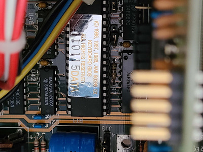

Reply 19 of 53, by elvovirto
jakethompson1 wrote on 2023-02-19, 06:32:
It could be this, especially with a 1989 BIOS. Re: JCS286/SCAT (82C235) Motherboard
Your original screenshot was using OnTrack; but now you are talking about the 504MB limit. Are you still using OnTrack? It might be enough to get around this problem.
I haven't tried using Ontrack or any other overlay.
I did go so far as to prepare the cards using Rufus and RMPrepUSB, but that got me nowhere. I'm currently playing with 32Mb cards. The next smallest I have is 2Gb and after that it's basically 32Gb cards.
I honestly don't know much about BIOS replacement. I'm attaching a picture of the existing BIOS ROMs.
