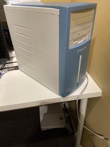

Hi. I just recently picked up this Packard Bell iMedia 5108, and one of my main goals is to restore it to as new condition with all the matching accessories. I’ve already tracked down the matching monitor, keyboard, and mouse, but I absolutely for whatever reason cannot find any information or model numbers about these speakers. They look like the ones here in this stock photo attached below mine. If anyone can help me figure out what model of speakers these are or if anybody reading this has a pair that they don’t need that would be very helpful.
