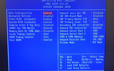

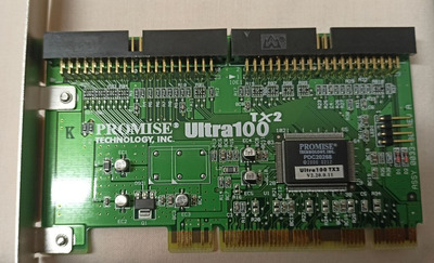

I'm having a bit of trouble trying to get my CD-ROM drive working with a Promise Ultra100 TX2 controller in a 486 setup (FIC 486-PIO2 motherboard). CD-ROM drive is a Creative CD2422E (24x) CDROM (IDE interface) and was working fine before I decided to install the controller. It was set up as slave at the mobo's secondary IDE controller.
At first, the Promise controller simply refused to run and the system freezed during POST, so I did the following :
1) Disabled integrated IDE controller (both primary and secondary) from within Award BIOS
2) Assigned IDE to PCI-SLOT4 using INTA & INTB
Tried for a while, changing some BIOS settings with no luck : controller's BIOS didn't show during POST (I have another Promise card running fine in a SS7 setup). Then I decided to get rid of the PCI Network card... et voilà, controller card info appeared during POST. It detected both master/slave hard drives attached to IDE1 connector of the card, but the CD-ROM drive, which was attached to controller's IDE port #2, wasn't detected. I'm able to boot from an MSDOS partition in the first hard drive (because hard drives were detected OK) but MSDOS freezes if I try to load any CD-ROM driver (via config.sys menus).
I tried to enable secondary IDE controller on the mobo and attach the CD-ROM drive to it but, when I did so, the system didn't boot up or freezed when loading the CD-ROM driver (which worked fine before Promise controller install). I've tried several drivers (VIDE-CDD, OAKCDROM) with no success...
Second thing I tried was updating controller BIOS to the last version via PTIFLASH utility. There was also no luck and the Promise card simply didn't boot after the update, so I had to reflash the old BIOS (I backed it up before flashing). Promise onscreen message showed up again during POST... but CD-ROM drive was still not recognized when attached to the Promise controller, IDE port #2.

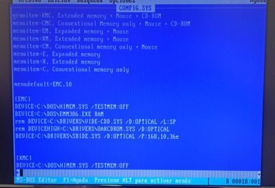

Third attempt: Replaced the CD-ROM drive with a spare DVD-ROM drive I had in storage (LG Model : GDR-8164B) and attached it to Ultra100 controller's IDE port #2... this time was detected at boot but I couldn't make it work under MSDOS because every attempt at loading a CD-ROM driver (VIDE-CDD, OAKCDROM) ended up in system freezing ¿¿?? If I chose not to load any CD-ROM driver within MSDOS, OS loaded and ran fine.
It seems to be some sort of incompatibility between this controller card and my particular mobo or maybe it's just me forgetting to set up something important, I don't know. I still have some things to try... I'll probably attach the Creative CD-ROM drive to the IDE port of my Soundblaster 16 Value PnP (model CT2940, which I think has a "real" IDE port) and will try to load the driver with the following settings (which I read about on another vogon's thread) :
DEVICE=C:\DRIVERS\SBIDE.SYS D:OPTICAL P:1E8,11  (Tertiary IDE, primary on sound card)
or
DEVICE=C:\DRIVERS\SBIDE.SYS D:OPTICAL P:168,10 (secondary on sound card)

Reply 2 of 11, by Babasha
Here the topic from 2001 in russian. https://forum.ixbt.com/topic.cgi?id=52:1799
They say CDROM's work only when there NO HDD connected to Promise.
Reply 4 of 11, by beltrixx
Babasha wrote on 2023-03-02, 15:03:
Ha! https://web.archive.org/web/20040717020517/ht … U100_TX2_DS.pdf […]
Ha!
see *2 on page 2
ATAPI devices not supported in DOS or Windows 3.1x.
Hi, thanks !
Interesting point, now I understand why my other setup (Epox MVP3G-M SS7 board, Promise Ultra1333 TX2 controller) didn't give me additional problems as the CD-ROM drive is attached to secondary IDE controller on the motherboard.
When you access Promise Technology download section (for legacy products), description for last BIOS (2.20.0.15) upgrade says : "Fixed cannot detect some ATAPI devices"
this, along with the fact the manual states (page 16) "NOTE: The Ultra100 TX2 BIOS supports both DOS and Windows 3.1x without software drivers." made me think it was possible to detect an ATAPI CD-ROM without further issues.
Anyway, somehow I was ready for such annoyances and thought I could attach the CD-ROM drive to any other port (I have two available : secondary IDE on the motherboard and Soundblaster 16 own IDE port) without problems ... but I haven't managed to get the CD-ROM drive working in either of them. It should, at least, work under DOS if attached to one of those, but normal MSDOS 6.22 boot process stops right after invoking the CD-ROM device driver line at config.sys (don't know why).
I know the card is 66 Mhz PCI but it is supposed to be backwards compatible with 33 Mhz PCI. It properly detects 2 hard drives attached to it and I'm able to boot MSDOS from the hard drive configured as master at IDE port #1 on the controller.
¿Shouldn't I be able to configure the CD-ROM driver without problems when using any of the available ports? ¿am I missing something?
Prior to the Ultra100 Tx2 installation, I configured the system to recognize the CD-ROM drive under MSDOS from the secondary IDE controller on the mobo, and set up a dual boot with DOS 6 / Win98 without issues.

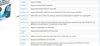

Thanks for the advice @feipoa but now I face another problem. I read your profile and maybe you can help me...
I used AFLASH3.exe utility to update the BIOS with (why I thought was) the beta Y2K update but... I chose the wrong BIOS or something... I messed it up, completely.
Now the computer beeps at startup but BIOS must be wrong and -obviously- it does not boot. It needs to be reprogrammed / flashed again, but it's the first time -in a lot of years- that I face this problem.
I was thinking of two different solutions :
1) buying a cheap BIOS programmer at Aliexpress which can flash 32 pin DIP bios chips
2) Another user from a Spanish retrocomputing forum told me about a procedure I find risky and I haven't done before :
a) Use a "healthy" motherboard with a similar BIOS chip
b) When this healthy system has completed the bootup process (MSDOS mode), extract BIOS chip (without turning it off, a hot-swap) and replace it with the faulty bios chip
c) Start the flash utility from floppy and flash the last BIOS file for my mobo (1.15C701)
d) When flash utility ends flashing the BIOS, turn off the PC and extract the BIOS chip
e) Put each BIOS chip in their respective motherboard sockets
Cross fingers...
Award BIOS versions for both my systems are similar but not the same :
Healthy System : Epox MVP3G-M, Super Socket 7, Award BIOS v. 4.51PG, 32 pin DIP chip (https://theretroweb.com/motherboards/s/epox-p … p3g-m-1mb-cache)
Faulty System : FIC 486-PIO2, socket 3 486, Award BIOS v. 4.50PG, 32 pin DIP chip (https://theretroweb.com/motherboards/s/fic-486-pio2)
Do you think this procedure may work? I've read AFLASH3.exe utility can cause some problems and Award FLASH v.5.2c should also work?

Once the EEPROM is reflashed, I'll take it exactly from the point I was in : trying the CD-ROM drive to work along with my Ultra100 TX2 controller and Sound Blaster 16 :
  • [1] Try to use SB16 IDE port (SBIDE.SYS) using tertiary / quaternary IO addresses
    [2] If I can't get (1) to work, try from the secondary motherboard IDE controller, something I had already setup quite easily before plugin in the Ultra100 TX2 card...
