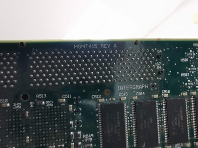

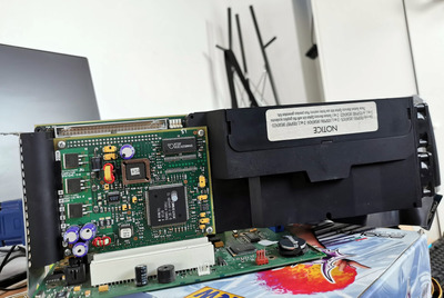

Can anyone help me with NT 3.51 / 4 drivers for Intergraph RealiZm II ZX25? The card was launched in 1997 and obviously must be compatible with NT4 (even NT 3.51), but the only drivers I could find are some later universal drivers for Windows 2000/XP. The whole Intergraph RealiZM line up is not very common since the MSRP for the card was $18K in 1997 (with monitor included), but this exact version MSMT415 is even rarer since the only reference I found was in a PDF.
Anyways, I don't think there is a special driver for this card but for the whole RealiZM II line up...

Well, good news. I found some working drivers on a Japanese website. http://www.fmworld.net/biz/vpro/lib/int3d/int3d.exe
These drivers are meant for the MSMT496 model. The card I have is a MSMT415 with 32 frame buffer + 64MB texture memory. I think this is the maximum. I don't know what performance to expect in GLQuake..., but they do install and do work.

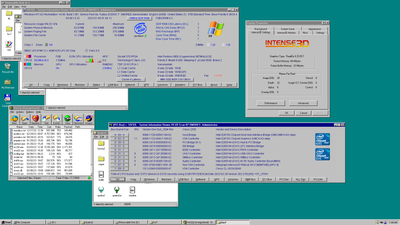

OMORES wrote on 2023-03-02, 21:05:
Good, does SIV report it on Menu->Machine->GPU Info, if so please will you post the screen shot, if not post the Menu->File->Save Local files and I will try and fix it.
It would be best if you updated to SIV 5.69 Beta-06 first.
Please will you post an export of HKLM\System\CurrentControlSet\Services\glzmpd ?

Reply 6 of 11, by OMORES
red-ray wrote on 2023-03-02, 21:42:
Done.

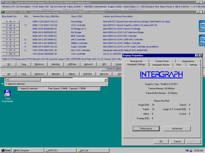

Reply 9 of 11, by red-ray
OMORES wrote on 2023-03-02, 23:54:
Done.
Thank you. Please will you post an export of HKLM\System\CurrentControlSet\Services\glzmpd ?
SIV reported RealiZm II, but the scan found the incorrect device. I should have fixed this in the attached SIV32L V5.69 Scan-07 test SIV, may I have new save files so I can check?
Do you have the card working with other than NT 4.00 and if so what does [GPU Info] report? From Windows 2000 the code path is very different to Windows NT4 and earlier.

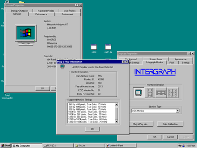

Reply 10 of 11, by OMORES
Thank you for the drivers. I installed the new drivers and they read now the correct DCC info so I can enable full HD resolution, but I end up with some vertical black bars. The image need to be stretched about 10% to cover the full display area. I experienced this also with my Voodoo 3 @ 1920x1080. With Voodoo 3 this issue could be fixed with PowerStrip.
I'm still very curios about NT 3.51 drivers. They must be on the original discs but I don't see anything archive.org

OMORES wrote on 2023-03-04, 12:51:
Thank you for checking out SIV 5.69 Scan-07. It worked as I hoped it would do, next I would like to report the RealiZm II clocks, but suspect finding the information on how to do this will be harder than finding the 3.51 drivers!
I was hoping there would be values in the registry as there are for the Texas TVP4020 Permedia 2 [GLoria Synergy], but there aren't.
