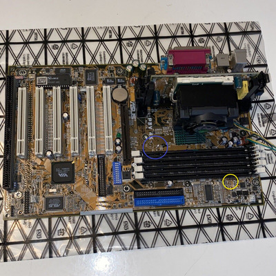

Got this Asus P3V4X Motherboard and the poor thing is sadly missing a few caps on the board I have identified the two larger missing caps (In Blue) but the small cap at CE29 I have no good pictures of to ID it. Does a fellow user have this board and can ID the cap at CE29 (Yellow Circle) for me ?
The attachment Asus P3V4X.jpg is no longer available
The two larger ones in Blue are 6.3v 1000uF 11.5 caps I believe, could you also confirm this is right ? (CE20,CE23)

Reply 3 of 13, by PARKE
TrashPanda wrote on 2023-03-03, 12:29:
CE29 looks the same as the ones sitting next to the mosfets in between the VRM coils.

Reply 8 of 13, by Grem Five
Here is the cap circled in yellow:
and the caps circled in blue:

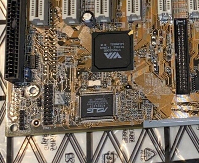

The mystery deepens with this board...New caps arrived and started the process of making the repairs and figured I would give the board another going over under some magnification glasses and well..
The attachment Asus P3V4X-Missing Crystal.jpg is no longer available
Its missing a 32.768Khz clock crystal...im getting more and more confused by what this poor board has been through, I wonder if it doesn't have deeper issues that will involve ICs at some point.
