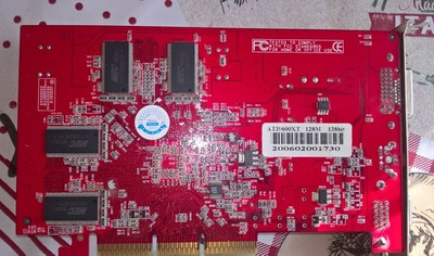

Tried this GPU, but I got 1 Long beep + 3 short beeps :[ Yeah, I know that it's about GPU detection. Is it possible to investigate further? AGP port incompatibility maybe?

Does the card work in any computer ?

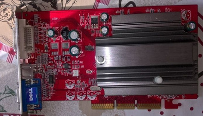

Yeah nearly all the Google images show a 1.5v only slot, plus since you mentioned it: it does not have the full compliment of onboard parts, many missing Caps,VRegs and others compared to most (many spaces empty compared to VGA Museum)

It is very likely due to a bus frequency issue between the agp and cpu.
(see page 15)
https://dlcdnets.asus.com/pub/ASUS/mb/slot1/4 … -f/p2bf-103.pdf
I encountered a similar problem with a 9800xt and an MSI socket A board which I ended up replacing with a 6800gt

GinnunGagap wrote on 2023-03-07, 21:51:
as written above, the 9600 is a 1.5V only card (AGP 4x/8x). BX - 3.3V - AGP 1.0 (2x).
If you're lucky, the video card may be alive.

Makavre wrote on 2023-03-08, 03:12:
9800 - power hungry card, with powering GPU from 5V and ... 3.3V (two-phase operation whith current sharing control).
Works normally only with native ATX MB, not on combined AT/ATX boards.

shevalier wrote on 2023-03-08, 05:36:
Technically, 9600 is not AGP 1.5v only card and can work with 3.3v signal, just like any other R3xx chip. Original ATi design just didn't bother with compatibility, avoiding a lot of angry customers with AT boards and horrible early AGP chipsets, which still were somewhat common. But some third-party designs with external power connection (just like on GeForce FX ultra cards) will work fine.
When you combine 9600XT with such poor cost cut-down PCB without external power - problems are bound to happen.

Reply 9 of 9, by bogdanpaulb
As stated above that's a bad implementation of that gpu . Try to run on it on a full atx motherboard and a old type 'beefy' 3.3/5v psu.
