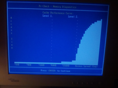

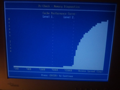

Reply 1 of 11, by shevalier
1. Jetway detect for newer CPU just half L2 Cache

    Turion 1M
    209.57 KiB
    622 views
    Sempron_256k&Athlon_512k

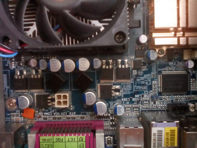

Reply 5 of 11, by shevalier
rasz_pl wrote on 2023-03-11, 20:20:
64 3000+ takes more power, if you have a scope take a look at cpu power rail
I have a Hantek DSO5000. All is well with cpu power rail.
I overclocked Turion to 2.2Ghz (FSB 220, HT 1.1Ghz, V core = 1.5), and it works well.
    301.71 KiB
    559 views
    Gigabyte

Yes, this is also a bios bug in jetways.
Turion is initialized with half of the L2 cache, but after the OS loads, the driver initializes it completely.
The problem is that Athlon does not work on Gigabyte, which E6 supports from BIOS version #1.
It looks like the CPU has a broken L2 cache, or memory controller

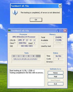

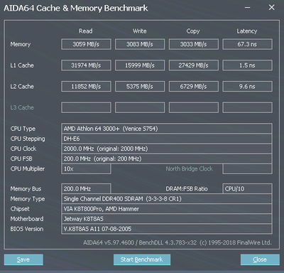

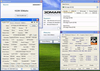

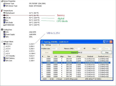

Reply 10 of 11, by shevalier
Managed to purchase another processor.
The same Venice 3000+ E6 1.35V.
And everything worked great, rock solid even 1.25V Vcore
After removing the heat spreader and using Zalman STG-2 between it and the core - about 40 degrees.
P.S. С_n_Q all the same does not work)))))
    110.64 KiB
    455 views
    40.23 KiB
    455 views
    36.85 KiB
    455 views
    67.09 KiB
    455 views
