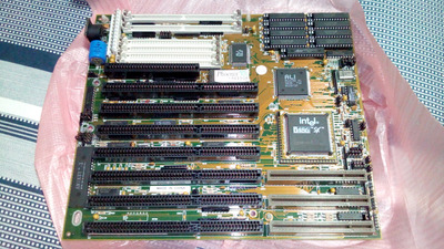

I have a VLB motherboard with this chipset. It performs quite ok as long as You are running a 33mhz fsb. As per the photo it supports 5v cpus only out of the box but I modded it to support lower voltage
cpu's. I tried a TI 486 DX2-80 but as has been reported it's slower than a dx2-66. I tried all the tricks with the jumpers but made no difference.
I'm quite happy to do dome tests and see if I can help with this.
There are a whole load of bios to try here https://theretroweb.com/motherboards/?showIma … 1&chipsetId=172
Some have Award, others Phoenix, and also AMI bios is used.
    1.4 MiB
    296 views
