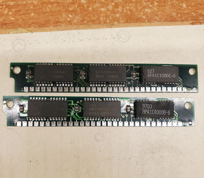

Reply 3 of 14, by pico1180
Please see attached photo. These are the two pairs I used. Both created garbled results.

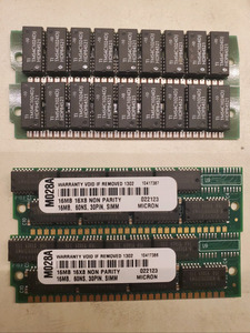

Reply 4 of 14, by JayAlien
I have a ct3600 although it’s not currently in a pc. I know you can run 32mb although I think only around 28mb is addressable in that case. I cannot tell the size of the first simms but I’d be interested to know if the choppy sound is still present if the total <= 16mb. Possibly you’ve already tried that.
As horun states, it should be 70ns or faster, but have you tried exactly 70ns simms? Apologies if the first pair in the picture is, but I see 60ns on the second pair.

Just to add to vstrakh's post.
The top pair are 1 MB simms each. Since there are 9 chips on each module, the one is for parity but, the access time for these chips are too slow in terms of the requirements for the Sound Blaster 32.
The bottom simms should work but, there might just be an incompatibility with the sound card.
Reply 12 of 14, by pico1180
I can confirm, the 32MB (2x16MB) pictured above does not work. Horrible chop. Sounds like the 1x2MB doesn't work because of insufficient speed. The below setup DOES work, but it sounds like absolute hot garbage. Bad distortion and cracking/garble. Though it isn't choppy so that is something.
I would describe it as distorted, garbled and phasing in and out with high to low modulation. Apposed to when I tried the 32MB setup where there was just blurbs of sound coming in with periods of silence at random intervals.

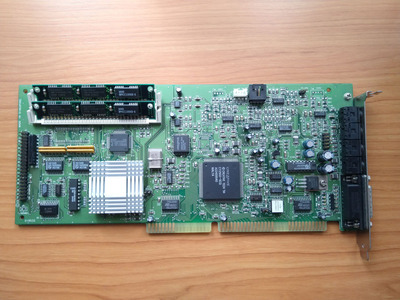

pico1180 wrote on 2023-04-07, 03:08:
With all the issues you are getting, please make sure that all address pins on the new RAM sockets are properly soldered. A missing address bit may cause issues as you describe. The effect of a missing address bit can vary with RAM size. I used to think that the AWE32 synthesizer test in DIAGNOSE doesn't use the sample RAM at all, but that may be wrong, it could try to upload stuff from SYNTHGS.SBK and use GS banks if available. A simple RAM test that just fills RAM with a fixed pattern and then reads back that pattern won't detect addressing errors. This could explain why the RAM test passes and the synthesis still fails.
To verify the theory of addressing errors in the RAM: Please try any real-mode DOS MPU401 application (e.g. DOSMID) with AWEUTIL. As long as there isn't anything horribly wrong, having RAM installed should make no difference when you loaded SYNTHGM.SBK (refers to ROM only), but you are expected to get issues if you use RAM-based samples, e.g. from 2MBGMGS.SBK.
