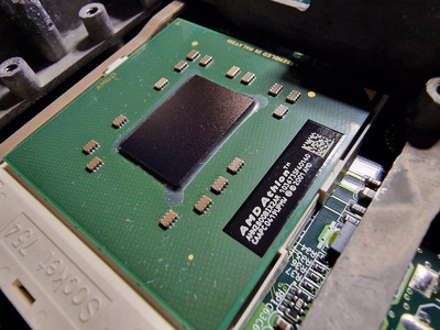

I've got another one, Presario R3200, opened it up to repaste the CPU but it's socket 754 Athlon XP, how weird! It has a GeForce 4 420 Go 32MB card.
Never knew there were Athlon XP's on socket 754! Everest 2.20 says it's a K8 ClawHammer chip.

Reply 13 of 19, by martin778
You're absolutely right! I also stay away from desktop CPU's like the Pentium 4(M).
Thankfully this is an athlon XP-M 2800+ but very weird to call it an XP-M as it's neither an Athlon XP anymore, nor an Athlon 64. It's something weird inbetween and K8 arch, never seen it before. The Presario R3000 runs on Nvidia nForce 3-150 chipset.

I'd try some other software. Everest may not be recognizing it correctly. Maybe the CPU isn't in its database so it's guessing. That sounds like a first gen Mobile Athlon 64.

Reply 17 of 19, by martin778
I've seen it with my very own eyes, it's this chip 😁
https://www.cpu-world.com/CPUs/K8/AMD-Mobile% … 2800BIX2AR.html
Clockspeed is definitely A64 equivalent as the S.462 XP-M2800+ ran at 2133MHz, this one at 1600MHz.
