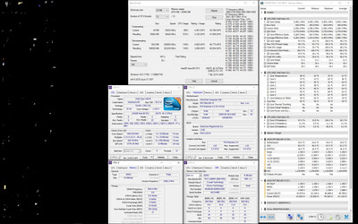

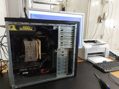

This is my workstation at work (where I sadly spend most of my waking hours during the weeks).
725.79 KiB
866 views
Last year I used this system to bin most of my 6-core Gulftown/Westmare CPUs. I find it important to have productive things to do at work...
Out of the X5670s and X5675s this one was the worst so I have used it for memory testing and for testing degradation. My best X5670 is one I bought new (but not at full retail price) back in 2011 for my SR-2 system.
Even a crappy X5675 is likely still a nice chip 😀
