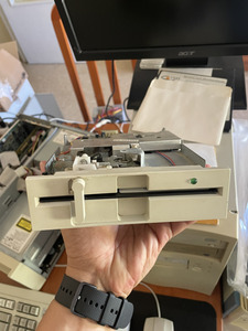

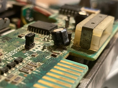

First post, by GEOCE
"I'm having a problem with my 5.25" floppy disk drive. It's very old, over 30 years, and it suddenly stopped reading disks. It's part of my INVES 386SX 25 Mhz computer. When I insert a disk, it acts like it's reading it, but I get an MS-DOS error message "Error initializing disk in drive B:". It's as if it's not detecting the disk. I don't know what to do, I've cleaned it and nothing. Can anyone help me and tell me from their experience how I could fix it? It has incalculable sentimental value and I don't know anyone who can fix this kind of thing." :_(

Reply 1 of 28, by Nemo1985
Forgive me but I wouldn't call it clean...
Check if the heads are clean. If the disk spindle but it's unable to read the best hope is that the heads need to be cleaned, go for a cotton swab wet of ipa.
Reply 2 of 28, by GEOCE
I have cleaned the floppy disk drive head twice, but it's as if it doesn't detect the disk. It's not detecting anything, and the head is not moving or lowering, and the motor is not spinning. It just makes a noise of attempting to read 'tacata tacata' and gives an error.

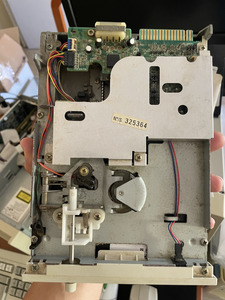

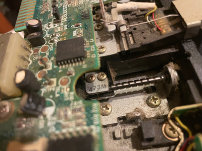

Reply 16 of 28, by Deunan
That drive is very dirty and dusty. Get a small wall painting brush with long, soft hair and clean it. Blow some air through it as well, especially after brushing. Make sure you clean the optical barriers but try to avoid brushing over the worm screw - it has some grease on it and that will stick to the brush (though it's not a big problem, brush can be cleaned, screw can get new grease and even dry but clean screw will work better then dirty one).
That PCB kinda looks like it suffered from a cap spill but it's hard to tell, might be just the dirt. In fact if brushing doesn't do much it might need a proper wash, but lets stick to dry cleaning first.

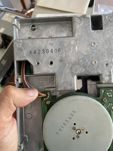

Can you rotate the spindle (the whole rotor actually) by hand, without using force? Does the the drive spin for a moment when you insert a floppy into it?
Reply 18 of 28, by GEOCE
Thank you Deunan. :_)
Which motor are you referring to? I'm a novice at fixing this type of floppy drives. The rotor at the back is working fine, it rotates smoothly when turned manually. When I insert a disk and turn on the drive, it doesn't rotate automatically. Which rotor should I manually rotate to see if it's not stuck?
https://www.youtube.com/shorts/SgtVsg9IqxQ

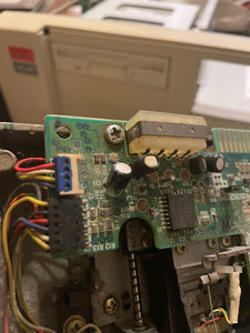

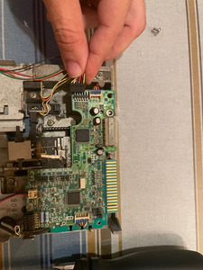

Reply 19 of 28, by Deunan
Spindle rotor is that big, flat and round thing on the bottom, I asume you turned it and it rotates. It looks like most of the drive actually works but there might be a problem with 12V power supply to the motor board, or it's not getting a clean control signal. Reconnect that small black connector on the side of the main PCB, maybe it's just corrosion and dirt inside. Do you have an ohm/volt meter?
