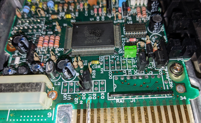

I need some help with two TEAC FD -55GFR units I'm trying to set up in my old Pentium SOYO Motherboard.
Tried with the integrated FFD controller, and also tried with a multi IO ISA controller. SAME RESULT.
One drive spins the floppy... no led light.
The other one shows red led light... NO SPIN
Trying with only one drive I get spin or light depending on wich connector I plug the drive.
Could you put some light in this issue?

Reply 3 of 22, by bing
Just one Jumper. The green one, allready tried on and off, no difference at all.

Reply 4 of 22, by Horun
Yours is a 55 FD-GFR-0xx . There are manuals for GFR-1xx , 3xx, 4xx, 5xx and GFR-7xx but not -0xx AFAIK. Let me check my archives...
added: Having "resistors" instead of true jumpers is a bit odd. I can say for a fact that if you are using this on a AT/286/386/etc that D1 should be jumpered, yours has D0.
That way the cable end floppy (after twist) is A, and the other is B drive. The U# ones are for LED response and if all off then for LED on with DC disk change and with DC being jumped. Yours has RY jumped.
My guess is they were not from a standard AT/PC but some OEM that needed things different for it's specific controller.

Reply 7 of 22, by weedeewee
while the jumpers haven't been soldered on to the pcb, the positions for them are clearly available.
D0 is even bridged by what looks to be a resistor, same goes for RY and HS and likely some others.
If the pins were soldered in you could have a field day trying out all the jumper configurations.
I guess you can figure out what to try next.

Reply 8 of 22, by Deunan
These drives are permanently jumpered to D0 and also with RDY instead of DC. So I'm pretty sure these came from Shugart bus - Atari ST maybe? I'm actually curious what machine used G* type TEACs that is not a PC...
To reconfigure those the resistors must be moved, or removed and pins for new jumpers soldered in. Well I suppose one could just use a piece of wire too (these resistors are probably 0 ohm or close to it) bu jumpers allow reverting back to original configuration more easily.

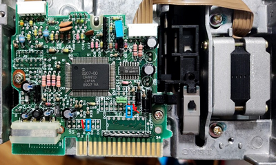

Reply 13 of 22, by bing
IT WORKS!
I cut the zero resistors in RY and D0, and put jumpers in DC and D1. Then I managed to turn a PC8801 drive unit in a working lovely AT compatible one!

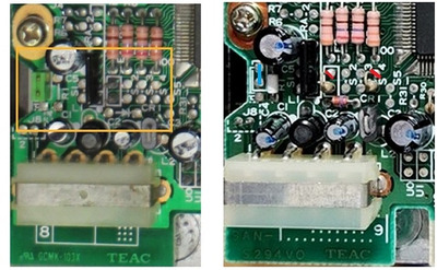

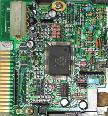

Reply 15 of 22, by Deunan
bing wrote on 2023-05-31, 17:03:
DC signal is not properly detected.
What did you set in the BIOS? Is the drive set to 1.2MB? Can you read entire HD floppy without any issues?
Try removing the I jumper (green on your photo), it shouldn't be required for PC operation - DC signal should work independently of speed settings but best to check.
Your other jumpes look like my GFR TEAC so I'm suprised it doesn't work... my drives were not dual speed from factory and do not have Q2 and Q3 transistors and the 3 resistors around them. I never bothered tracing the PCB to see what those do, but you can investigate if any of these transistors leads are connected to RDY or DC.
EDIT: Maybe this photo will help you.
    412.85 KiB
    1588 views
Reply 16 of 22, by Horun
Nice Deunan ! I noticed there are a few other changes yours has but bing's does not: FG jumped for frame ground.....
S1 and S4 no jumpers but that could have to do with the speed, no mention in the doc 504.pdf.

Reply 17 of 22, by bing
Thanks Deunan and Horun.
I did it!
Step by step:
- Yes, BIOS says it's a 1.2Mb unit
- the I jumper must be ON to get it working 300 rpm or 360 rpm (depending on the HD signal). Deunan, your drive works with HD floppies in DOS? It seems to be configured to get ALLWAYS 300 rpm, I'm a bit confused about it.
- The top left jumper it's not necesary in my unit, the Ov signal is attached to the frame by the 'R1 thing'.
- I coundn't find any information about S1 to S4, no idea about what are they for... but you were pretty close.
The first resistor you proposed to cut is not S1 (yes, S1 is far away from S2, just on the left of the 'black thing') is E2,
In retrocomp.de info you could find:
Set the E2 strap to the ON state only if your computer requires MASKING THE INDEX. (i.e. PC and older PC/XT that do not give the drive enough time to reach a ready state when the disk replaced.
I cut this resistor and BINGO! Everyting works!
