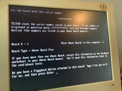

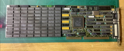

Hi,
i have a Problem with my AboveBoard:

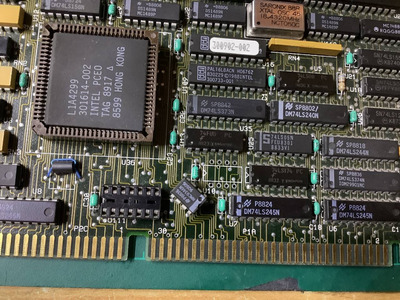

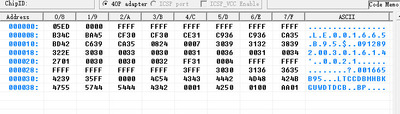

i removed the ROM because of this:
Maybe someone with the same card could dump the ROM ?
It seems my Serialnumber "le001665b95" is intact inside the ROM.
It also reads EMS Configuration from the ROM.
First row seems weird.
A Friend also has a AboveBoard but his ROM Content and Model is very different, so it does not help me 😒
