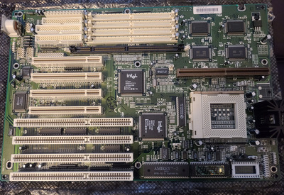

Hi all,
I've got ECS P5VX-B Rev 1.2 Socket 7 motherboard and can't get it to work or do anything. Maybe someone has got any ideas or had simular or dame issue would be great if you can share any useful info.
It doesn't post, no beeps. Nothing. Under thermal imaging cam looks like all temps are OK between 30 and 40 Celsius. Only one part get hotter to around 40-50 Celsius is Winbond W83768F but this is the I/O controller I belive dont think that this will cause any problems.
Processor, ram, video card are fine, power supply too. All tested on other mobo and no issues.
I already replaced caps but no go.
Any help ?
Thanks

jakethompson1 wrote on 2023-05-11, 19:27:
You're missing a real time clock chip (DS12C887A+ or similar) in that empty socket
On a pic attached yes but I've got two of these. One original (dead) and the other one modded with CR2032 battery. When tested it I've used both just in case but no difference.

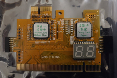

Reply 4 of 24, by Robx66
Repo Man11 wrote on 2023-05-11, 20:02:
The only advice I can offer at this stage would be to obtain a POST diagnostic card.
Already tried it. The only thing it shows is one led on (PCI RST) Nothing else shows on it.
Tried on different working Socket 7 motherboard and had exactly the same result which is pci rst led on.

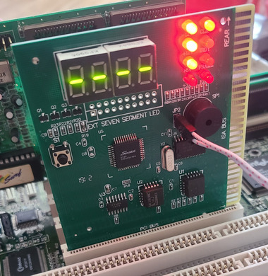

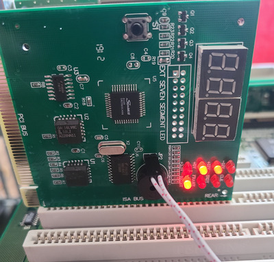

Reply 19 of 24, by Robx66
Post card finally arrived so plugged it in and that's what it shows.....
It's in PCI slot, no codes, all leds on apart from 3.3 Volts, irdy, frame, reset. No beeps
In ISA as you can see.
Dead ???? or there is still something I can do or try ?
