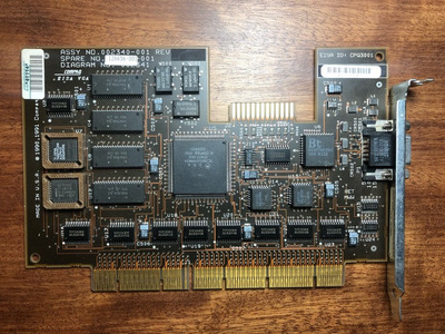

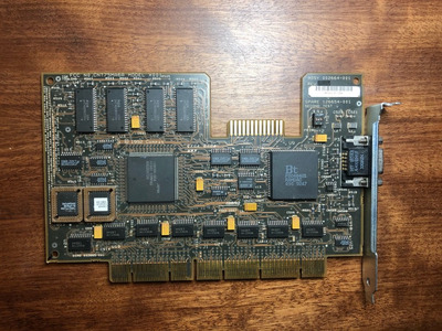

Today i had the opportunity to buy two EISA VGA cards.
This was not really planed, i was interested by some ISA network cards, and the seller also presented me two EISA VGA cards.
After an hesitation, i finally bought them. Half because i wanted an early 90's system and half because they were not crazy expensive...
But i'm not really familiar with this era (was too young, i'm more familiar with mid/late 90's stuff)
I started to look for motherboards, (mostly Compaq boards) but i don't really know what to look for and what to avoid.
I have no immediate need for such a system, so i can wait a bit until i finally gathered the stuff.
But since i'm out of my comfort zone, i would love some advice (Brands, what to avoid, prices ranges)
Or should i just sell the cards and look for ISA / VLB system instead ?

Reply 1 of 9, by TheMobRules
EISA is interesting, but when it comes to video cards it will not give you noticeable advantages vs regular ISA. I have 2 EISA motherboards, one with a proprietary local bus slot (ECS) and one with VLB, so I use those for video instead since the performance is way, way better than ISA/EISA. But for other expansion cards such as networking or HDD controller it's cool to tinker with EISA.
Also you would need an EISA motherboard, they're nothing special really, but due to being somewhat rare compared to ISA/VLB sellers will often jack up the prices to obscene levels. It took me a while to find EISA boards for a decent price (say, less than $75). So my suggestion would be to sell those EISA VGAs and use the money to get a nice ISA/VLB board + cards. For some strange reason, when it comes to EISA, you can usually get lots of cheap expansion cards, but VGAs, despite their mediocre performance, command ridiculous prices.
Reply 2 of 9, by Anonymous Coward
I think these are 1MB cards. The one on top seems to be newer and has a beefier RAMDAC. If you're going to keep one, keep that one.
I really like EISA stuff, but these days I wouldn't go out of my way to buy a board unless it was cheap.
My feeling is that this card would be best at home in a 386 system (basically all of them are OEM built proprietary jobs, so you'd need a complete system).
486s really need local bus video.
It's said these cards don't show much of a boost in DOS, but accelerated graphics in Windows is a different story.

Reply 6 of 9, by maxtherabbit
TheMobRules wrote on 2023-05-14, 19:01:
The QVision shown in the top pic is faster than an ET4000AX. It's better than any ISA cards. Mine nearly keeps pace with a low end VLB card like a GD5426

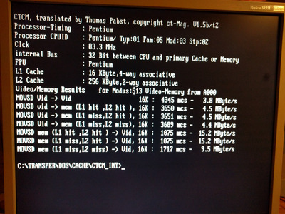

Hello,
I disagree. So I agree with maxtherabbit (last post at the moment): Especially the Compaq QVision 1024/E is good in DOS.
I made some benchmarks
Re: The Ultimate 486 Benchmark Comparison
I don't think this throughput is possible with an ISA card.
Reply 8 of 9, by Disruptor
CoffeeOne wrote on 2023-05-16, 19:21:
I disagree. So I agree with maxtherabbit (last post at the moment): Especially the Compaq QVision 1024/E is good in DOS. I made […]
Thanks for the benchmarks. I'm impressed by the write rates; I never have used that benchmark.
Too bad you have run SpeedSys without a VESA driver.
And you may use ctcm from c't/heise also with the /vid switch.
Reply 9 of 9, by CoffeeOne
Disruptor wrote on 2023-05-16, 22:08:
Thanks for the benchmarks. I'm impressed by the write rates; I never have used that benchmark. Too bad you have run SpeedSys wit […]
I powered on the big server 😀 No tantalums exploded, at least I did not hear something.
For some unknown reason speedsys hangs on "detecting memory type". Damned. I have no clue, have to investigate.
ctcm is running, I ran ctcm 1.5 international with vid parameter
