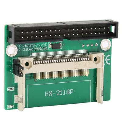

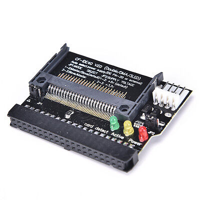

i'm just about to give up. is there any off-the-shelf cf solution that is udma 66/100 compatible? i first purchased this adapter:
28.96 KiB
737 views

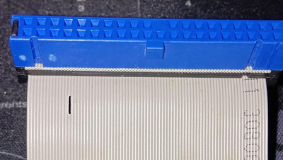

how nice that they provided a totally useless 3.3v voltage regulator jumper instead of udma 66/100 support...i mean, who could possibly want that? so i figured why not add a bulky 80pin ide cable to willfully clutter up my cable management so i purchased this next adapter:
60.69 KiB
737 views
again, my motherboard only detects a 40pin ide cable and limits speeds to udma 33. is udma 66/100 ever going to work or is it hopeless without modding the adapter?
the motherboard is an iwill kk266 plus and it only complains about a 40pin ide cable when the cf adapter is attached. the 80pin ide cable i'm using only has 2 connectors if that matters, but they are properly color coded blue and black for the motherboard and master device.
can i buy something else? if soldering is the only solution i'd rather go back to a mechanical hdd. frankly, whether thru an ide, pcmcia or usb adapter my whole foray into compact flash has been severely underwhelming.

Reply 4 of 15, by vstrakh

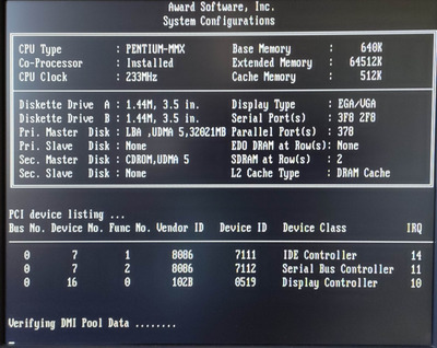

The second one, the HX-2118P with Transcend 4GB/8GB/32GB cards makes it into UDMA 5 as reported by the bios on a 430TX Socket-7 system.

Reply 6 of 15, by stanwebber
vstrakh wrote on 2023-05-20, 05:23:
thanks for the verification. i tried another 2 connector (single device) cable, that's never given me problems before, and got the same result, but when i swapped in a gnarled 24in 3 connector cable--bam, it detected the 80 wire conductors. (the cable only has to go 3in AT MOST for the adapter and now i got 24in of intestines.)
i'm a little perplexed on why this is happening. what is going on inside the connectors? i previously assumed blue, grey and black were all internally identical and the location of a cut wire determined the cable select positions. (so maybe without the cut wire only the blue/gray connector is different from the other 2...after all you can plug an 80 wire cable in backwards and only the cable select is affected.) i've tried to find internal diagrams online, but there are so many junk search results to wade thru
Would be impressive considering TX only supports DMA Mode 3 😀 That text is meaningless, its Drive capabilities reported by "identify drive" command.

Reply 13 of 15, by Chkcpu
vstrakh wrote on 2023-05-21, 05:01:
rasz_pl wrote on 2023-05-20, 21:49:
Didn't know 😀 I've jumped over socket 7 back in the day, going from 486 into P2, missed lots of fine details...
@rasz_pl, actually the i430TX chipset supports maximum UDMA 2 mode. But you are correct, this BIOS shows the maximum supported UDMA mode from the drive, not the actual UDMA mode used by the board/BIOS.
@vstrakh, this UDMA 5 display from the Award BIOS on your TX board is a BIOS bug. This bug is the source of the Windows 98 DMA issue.
I found that Windows 98 doesn’t like the BIOS reporting higher UDMA modes on older hardware and refuses to use any DMA mode when set in Device Manager. This results in a fall-back to PIO mode 4 with reduced Harddisk performance.
I’ve tested this on my i430TX board with an 11/1998 Award BIOS and a clean Win98 install, so I was using the standard Microsoft Bus Master IDE drivers.
Indeed the DMA mode would not stick and the atto disk benchmark measured a poor 9MB/s.
Luckily most Award BIOSes from 03/1999 or later have a fix for this UDMA bug so you may need a BIOS update for your board. I’ve tested an updated BIOS with this fix on my TX board and the BIOS now correctly showed UDMA 2 on UDMA 5 or 6 drives. In addition, Win98 allowed to select DMA in device manager and after a reboot I got 30MB/s in atto disk benchmark! 😀
