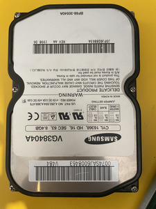

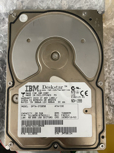

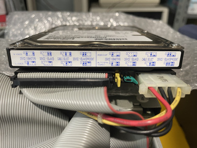

Hello everyone. I got myself an IBM disk to put inside one of my IBM computers (as you know I choose to have only IBM brand computers in my backs). The disk in question is a Deskstar 7200 rpm and 20Gb and I chose it because it seems to me to have been the first 7200 rpm and therefore legendary for the time. But the problems started... it seems that the computer in question IBM PC330 P200 is limited to 8.4Gb (currently there is the Samsung disk that you see in the photo). By doing various combinations in the IBM disk between 15/16 Head the bios manages to see an 8GB disk but then DOS 6.22 formats it to 16MB! and windows 98 fails to install, even using fdisk in DOS and win95 version you are unable to partition / format correctly, in short, the bio sees it as 8GB but then the operating systems are unable to manage it. But if with the jumpers I set it as 2GB limit it seems to work and under DOS 6.22 it installs and sees 2.1 GB.

I think you are over-complicating things here. Yes, it appears you have a BIOS with the 8.4GB limit. To overcome it (and since the jumpers only allow limiting the capacity to 2GB and not 8.4GB) instead of trying different geometries just install some Dynamic Drive Overlay software (DDO) like EZ-drive.
Then there is the OS with its own limitations: DOS 6.22 doesn't know FAT32 like Win98 do and is limited to 2.1GB partition size. I suggest using only one boot disk to setup the HDD and not mixing things up, for example if you want to install Win98 use a Win98 boot disk, partition/format the disk with Win98's fdisk and then install windows.

The BIOS was designed in an era where HDD sizes were smaller. It would require a BIOS update (if available) or using DDO (Dynamic Disk Overlay) to get around the 8.4 GB limitation.
Same goes for MS-DOS 6.22, there is an upper limit of 8 GB per HDD and 2 GB per FAT16 partition. You have to make multiple partitions as a workaround.

the best solution for using that 20gb drive would be hooking it up to a promise controller, which would allow to use its higher UDMA modes, not that it would matter that much on a pentium. ezdrive on the other hand probably costs a bit of performance and locks you into using that software, which might be annoying should you choose to put the drive into another machine.

Because the BIOS doesn't detect the disk as 8GB,
AlessandroB wrote on 2023-05-20, 17:28:
...By doing various combinations in the IBM disk between 15/16 Head the bios manages to see an 8GB...
you somehow specified a weird 8GB disk that is obviously not correct/operational geometry.
