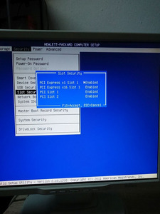

So, I bought the HP RP5800 TFF PC with the intention of turning it into a WinXP retro gaming machine. The WinXP installation went well, but things went south after I connected a low profile Radeon HD 7570 PCI-E to the onboard PCI-E x16 slot. The GPU fan is spinning, so I guess the card does receive power from the MoBo, but I can't get it do display anything. And WinXP doesn't detect it - it's missing in Device Manager. What is more, I can't find any BIOS options that would allow me to toggle between the onboard VGA and the dedicated GPU. Any ideas?

This has a TPM, you need to set up the security section and other items to allow GPU in the security white list sections.

Thanks, but how do I do that?? 😳 I don't think there's such an option in the BIOS, unless it's in some hidden advanced settings menu that I don't know how to access.

Explore rest of the bios settings. Most of it in security and last tab menu has some as well. I have many HP computers but not the POS machine in my herd.

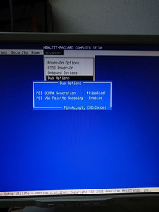

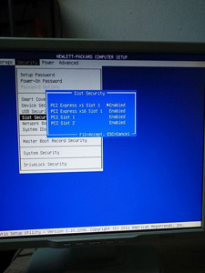

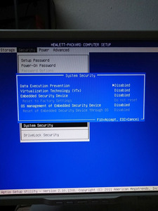

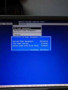

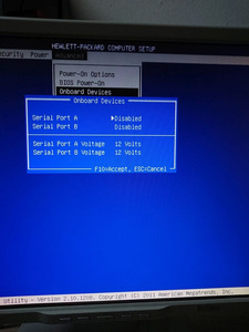

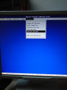

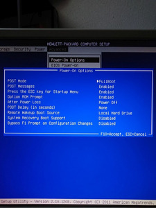

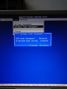

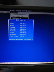

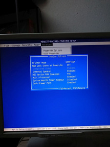

Reply 9 of 21, by revolstar
pentiumspeed wrote on 2023-05-22, 16:57:
Cheers,
All I got is this:

Reply 10 of 21, by revolstar
(cont.)

Reply 11 of 21, by bogdanpaulb
try to disable the slot security for the pci-e 16x (or maybe all slots), makes sense if it has TPM.
    62.69 KiB
    1176 views
Reply 12 of 21, by revolstar
bogdanpaulb wrote on 2023-05-22, 18:56:
That doesn't work either 😒
