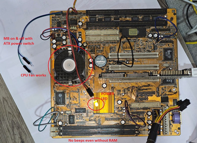

Hello,
I had this PCCHIPS M571 (probably a LMR variant, SIS5598 chipset as I remember) motherboard for a long time and last time it worked should be around 2007, when I had it as a FreeNAS server. I vaguely remember it didn't POST when I put it in the storage. I found a bit of corrosion too.
The Pentium MMX 233 MHz was already installed when I put it in the storage. Before everything, I replaced CMOS battery and cleared CMOS using jumper few times.
With an ATX PSU (PSU is fully working, this is a modern PSU which I use to test everything), the board powers on (Power LED also lights up) but there is no beep on the buzzer even without installing RAM sticks. ATX power switch turns on and off (with 4 sec press) normally. CPU fan works normally too. Other than that, the MB and looks like MB is pretty dead.

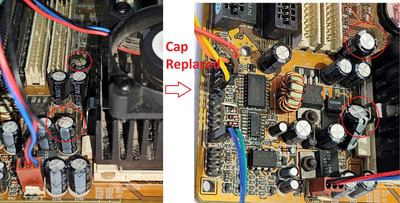

I found 2 bad capacitors and replaced them, but there is no difference.

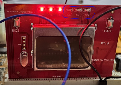

Then I tried with a PCI POST Test card but there is no light on +3.3V (did Socket 7 motherboard had +3.3V anyway ?), CLK and SYS. The LCD is also showing nothing (so no activity?).
(card is full working, tested on my P4 and all LEDs did light up and LCD was showing the boot process)
My original plan was to restore my old PC with my P-MMX CPU (originally I had ASUS SP97-V with this CPU when I got this PC in 1998, it was dead around 2002 and I replaced MB with this used PCCHIPS motherboard) but I couldn't find a cheap motherboard supporting P-MMX on Ebay. Most of the ones available are for Pentium only (I found DataExpert TX531, Gigabyte GA-586VX, FIC PA-2005, Abit AB-PT5, ASUS PCI/I-P54SP4 etc). I also found a "IBM USI Pro263" Super Socket 7 mATX MB on Ebay but it only support AMD K6-3 and originally from an IBM Aptiva model 2187.
I am wondering whether this MB could be revived or just let it RIP without investing more time and money on this.

    Bad cap replacement

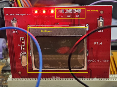

Thanks for the info. I have tried with AT PSU adapter and the situation is still the same (PCI POST card doesn't show 3.3V, CLK, SYS).

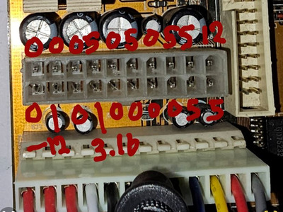

I have measured voltages at ATX socket when AT PSU is connected and there is no 3.3V at there as well.

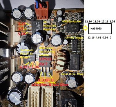

Also I tried to check power regulator ICs and I have measured the voltages as shown in the photo below.
The continuity between 3 * 3.3V pins in the ATX socket is "infinity" so they are not connected at all.
I also tried to inject 3.3 V with an external regulator to each pin but no indication on POST card 3.3 V LED.
Is there any thing weird or what else could be checked ? I don't have an oscilloscope with me.
May be this motherboard doesn't use 3.3V at all and PCI post card doesn't work without 3.3 V ?

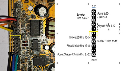

What's the deal with this jumper?

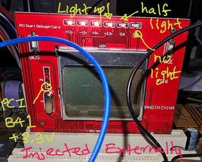

### UPDATE ###
Just to confirm whether 3.3 V is needed to run PCI POST card, I tried below steps.
I found out that 4th PIN pf P4 connector in PCI POST card is connected to B41 pin of the PCI slot which is +3.3 V.
I injected 3.3 V to that pin using an external 3.3 V regulator powered from floppy power cable.
Then POST card 3.3 V LED lighted up but CLK LED is faintly lighted up. No display is on the POST card LCD display.

Reply 9 of 19, by dionb
Old pre-PCI 2.2 boards didn't supply 3.3V to the PCI bus, so nothing abnormal there. That's why later PCI cards that require 3.3V don't work on older boards without modification.
So lack of 3.3V is not your issue stopping POST - that board would never have had 3 3V on PCI.

IMO, the voltages of VRM on your photo look good: Vcore about 3V, Vio about 3.5v.
That is actually the front LED/SW header. As I remember those broken pins were NC anyway.
Looks like a bent pin and soldered to a transistor. Is that factory?

Sorry for the confusion, that pin in J8 isn't soldered to anything and NC as per manual.
Version of my motherboard is V5.1
Also I can recommend youtube channel by Tony359 and his video about reviving PCChips board:
https://youtu.be/1kVps2oBmhs
Thanks a lot for the information . I will go through that. I think I got the manual from the same site a while ago.
About Vcore, doesn't it looks a bit high. I think Vcore should be 2.8 V for Pentium MMX 233 MHz (https://www.cpu-world.com/CPUs/Pentium/Intel- … BP80503233.html)
May be this board starts with default 3 V and later reduces when actual CPU is detected from BIOS.

It's nothing. I suppose you're right. I meant pentium mmx should work even if Vcore or Vio is slightly higher. So there's something else that totally prevents normal start. Maybe if you scrutinize the mainboard you'll manage to find some scratches or damaged smd components. Good luck!
Reply 19 of 19, by bazingaa
#UPDATE#
Got a PCChips M585LMR and tested CPU on that. CPU is working.
Also got a Pentium-MMX 166 MHz CPU and tested on M571LMR, no signs of life. So, I have given up the resurrection for the time being. 🙁
Also PCI POST card doesn't show any SYS or CLK or LCD display on that working board.
Conclusion : These PCI POST cards are not suitable to troubleshoot Socket 7 motherboards 🙁
Thanks a lot for the support guys! 😀
