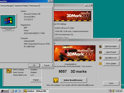

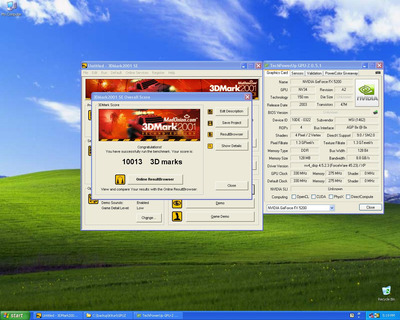

Yes, but it depends on what will you use the pc for. If you want dos and win98 or win98 only(no XP) there is no point in going with a 'high tier' cpu. You will have a lot of heat generation for no reason. In the pictures you have the same video card running on the Sempron kit (win98) and the 775 kit(winXP). I prefer the much cooler/colder Sempron.
