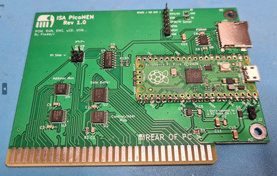

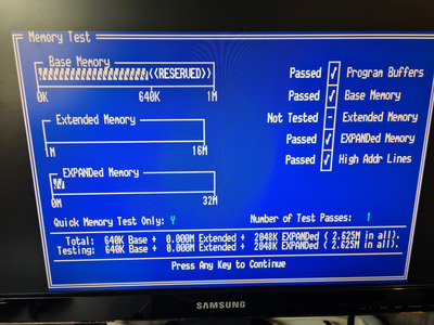

The PicoMEM is designed as a way to run Emulated ISA boards on a real PC.
The PicoMEM Board currently connect the full 8Bit Memory and I/O Bus plus an IRQ to a Raspberry Pi Pico, through some multiplexor/Level shifter chip.
The Pi Pico also has a 8Mbyte PSRAM connected in SPI and a MicroSD Slot.
The PicoMEM Board can be seen as both a working PC extention board as well as a Development platform.
Board description

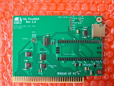

Hardware :
- 2 Layers ISA Board connecting a Raspberry Pi Pico through some buffers/Multiplexor and inverter.
- The Pi Pico is connected to the full Memory and I/O Address space, and one IRQ. (No DMA)
- The Pi Pico is connected to a PSRAM (8Mb, 130MHz, PIO) and a MicroSD slot (20MHz, PIO) in SPI.
- The Pi Pico is used at 260MHz.
- The MicroSD connector share the SPI BUS of the PSRAM, adding some limitations. (We need to stop the PC IRQ during Disk Access)

Advantages
- The Board design is simple and the Pi Pico is available : Quite easy to produce, not expensive.
- As it is mainely software, the limits are only the imagination (And Time)
- If we check the currently available functions, even if one of them was working, it was worth to do the board.
- Can be used by anybody to experiment in coding, from ARM side and PC Side, in fact it is one of the main goal for me to do this board : Learn
- Can be used to test Emulation code on Real Hardware : This is a bridge between emulator and real hardware.
- This is not based on a super overpowered CPU that can do everything. There is a real challenge to have this working.

- Memory emulation with 16Kb Address granularity:
> 128Kb of RAM can be emulated from the Pi Pico internal RAM with No Wait State. (4MHz ISA)
> We can emulate the whole 1Mb of RAM address space from the PSRAM. (With 6 Wait Stated for 4MHz ISA)
> EMS Emulation of Up to 6 / 7 MHz. (Only 4Mb for the moment as using the LoTech EMS Driver)
> Memory emulation is also used to add (4Kb of "Private" memory for the PicoMEM BIOS Usage)
> 16Kb of RAM is also added for disk access (Or other) even if 512Kb only is used for the moment.

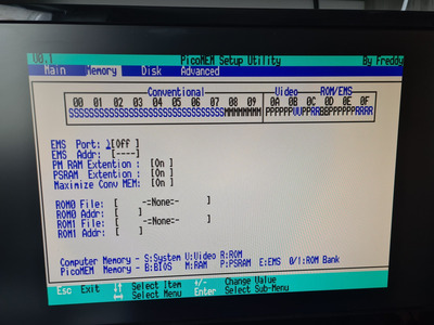

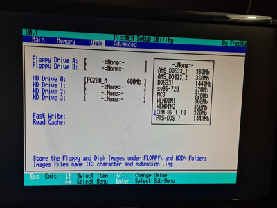

- The Board has its own BIOS, used to automatically detect/Extend/Configure the RAM emulation, and select Floppy/Disk images
- Floppy and Disk emulation from .img files stored in uSD through FasFs and DosBOX int13h emulation code.
- Emulate 2 Floppy and 4 Disk (80h to 83h), Disk up to 4Gb (More later)

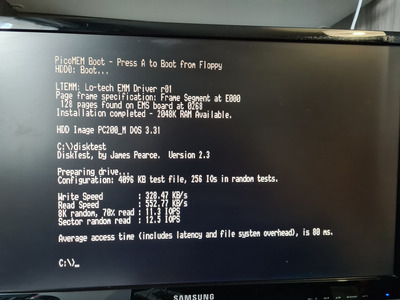

Disk emulation:
uSD Disk access are really fast even compared to the XTIDE, but it it currently limitted by the uSD acces time for write.
The Code reading multiple sectors failed in one of my uSD, so I did not enabled it for the moment.

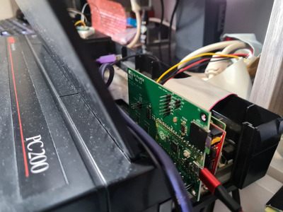

Tested machines:

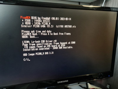

- IBM 5150, 5160, 5170 : All Ok, except keyboard not responding on 5170.
- Compaq Portable 2 (286): Ok
- Amstrad PC1512, PC1640, PC200: Working, but fail to start all the times on one PC1512 and sometime on PC1640.
- Tandy 1000 : Does not work yet due to the specific memory map.
- Worked on Various 486, 386 (No confirmation of the ISA Clock speed yet)
- Failed on a 386 with 8MHz ISA Clock

The PicoMEM Board in the Sinclair PC200

BIOS Menu : RAM config and image selection

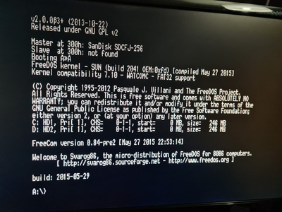

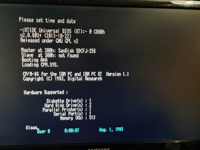

Reply 1 of 131, by FreddyV
Other pictures:
571.19 KiB
10032 views
506.1 KiB
10032 views
326.51 KiB
10032 views
435.8 KiB
10032 views
Disktest speed is NOT the real speed, as IRQ are disabled during disk access, the reality is smaller (But not that much)

The SETUP Utility IS a BIOS, it is started as a ROM extention (ROM Emulation)
