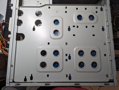

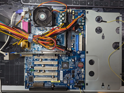

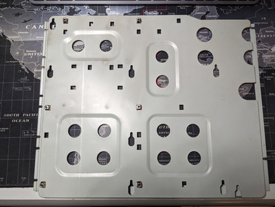

Reply 10 of 21, by mrfusion92
You all made the assumption (rightfully) that when is inside the case I tested it in vertical position... but actually not, It was always in horizontal.
Tetrium wrote on 2023-05-25, 08:30:
Googling "9 short beeps" gave me this:
Nine short beeps mean that there has been an AMIBIOS ROM checksum error.
Yes I have read that but it doesn't do only the 9 beeps, after a brief pause it makes 3 other beeps.
I was in hurry during lunch break so I could make only these three pictures. After work will do more.
The tray
1.47 MiB
1128 views
I'm using three plastic standoff for the rightmost holes, here the motherboard POSTed correctly
1.83 MiB
1128 views
From the back inside the case, didn't had time to test it again
1.07 MiB
1128 views
