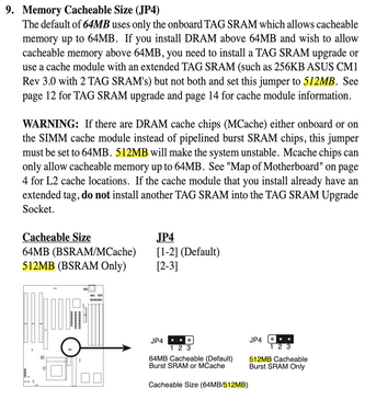

Does anyone know what the tag ram socket on the P55T2P4 rev 3.10 motherboard is for? On the earlier rev boards I understand that you need to add an extra tag chip to have enough tag ram to cache the full 512M of ram (along with a coast module). However on rev 3.10, it doesn't make sense to me. The rev 3.10 board has no separate COASt slot because it is already maxed out at the max of 512KB of cache, and it would seem to have enough onboard tag to cache the full 512MB of supported ram.
download/file.php?mode=view&id=164911
My system has 96MB of RAM and with or without a tag chip installed, everything seems to behave the same in the 512MB position. If the board can cache 512M with the hardware onboard, what's the point of the tag slot?
I haven't been able to see any difference between having the jumper in the 64MB or the 512MB either (though the board won't post with a tag chip and the jumper in the 64MB position). Is there some kind of benchmark or test that would the performance of the cached vs uncached memory? cachechk seems to only go up to 64MB, so that's not much help.

Reply 1 of 8, by majestyk
You do need the 2nd TAG chip in order to enable the full 512MB cacheable area. It´s not about TAG size here but about expanding the TAG I/O bus from 8 to 11 bit.
You can check the difference with the tool "CTCM7".
If you run CTCM7 on your current configuration you will see that out of 96MB RAM only 64MB are cacheable. This means a performance loss if you run an OS that starts using RAM from the upper end like Win95 or 98.
If you are fine with just 64MB RAM you don´t need the second TAG chip. This is why ASUS and others left the 2nd TAG socket unpopulatated: They saved money and assumed many customer wouldn´t have more than 64MB RAM anyway and those who would could pay for the 2nd TAG chip themselves.

Reply 6 of 8, by mbarszcz
majestyk wrote on 2023-05-28, 05:09:
The reason why I recommended you use CTCM"7" (seven!) is that it´s results are more straight forward. It explicitly tells you the cacheable areas of L1 and L2.
Where can I find CTCM 7?
Reply 8 of 8, by mbarszcz
Thanks for the copy of CTCM7. That was a really hard piece of software to find.
Just like you guys said, CTCM7 shows the expected results of caching 64MB+ with the tag installed and the jumper in the 512MB position. I appreciate you taking the time to clarify and explain what the jumper and the tag ram really do on this board. After this testing, it seems the jumper could have simply been left out and hard wired in the 512MB position, and then the presence of a tag ram (or not) would determine whether the ram above 64MB was cached or not.

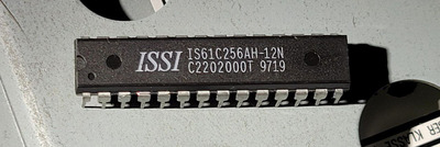

Here's a picture of my tag ram, ISSI IS61C256AH-12N
file.php?mode=view&id=165150
Tag ram IC installed, 512MB jumper position

No Tag ram IC installed, 512MB jumper position.
Everything appears to work just fine without the tag ram, but ctcm7 does show that memory above 64MB isn't being cached.
