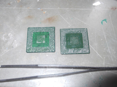

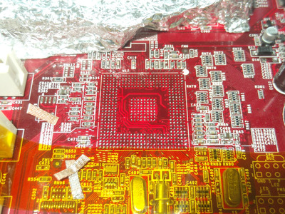

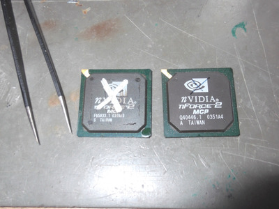

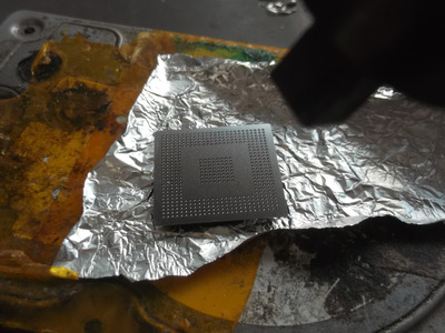

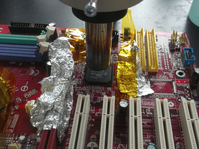

Reply 4 of 19, by DAVE86
Decided to remove the bad chips while I try to source replacements. I used an aging setup consisting of a ceramic preheather and a hot air rework station. I used this ghetto setup before on larger things and there were never any issues.
First I practiced on a beaten up Gigabyte GA-7n400. Figured out the temperatures and stuff and the chip came off nicely. PCB is fine.
904.46 KiB
1727 views

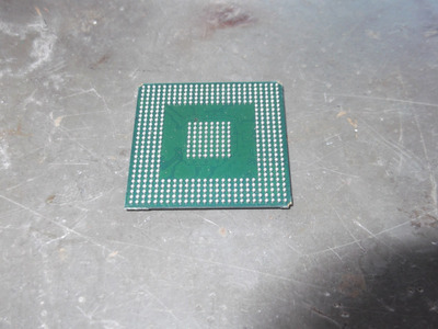

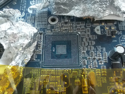

The next was one of the boards that got killed by that diag card. MSI K7N2. Also no issues. Clenaed the pads on the board. Looks good.
708.35 KiB
1727 views
Nforce2 MCP rev A and S removed

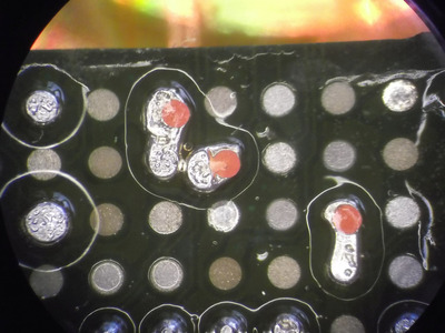

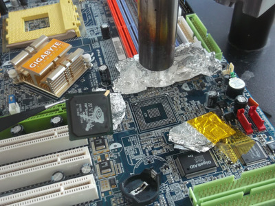

And last the other victim, Gigabyte GA-7n400 Pro2. This has the most features.
732.06 KiB
1727 views
This time it went not so well. Like before the chip came off the board... and took some pads with it. Must be something with the solder expanding, some stress or I don't know. I was dissapointed. Though it seem that these pads don't connect any circuit traces it is still worrying.
Also the resist mask got damaged on the board a bit so I have to fix it up before the rework.

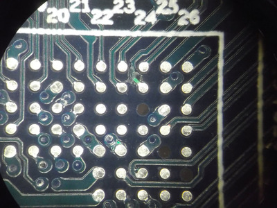

Reply 5 of 19, by DAVE86
This is how the damage looks on the board and the chip:
413.48 KiB
1726 views
451.27 KiB
1726 views

Reply 15 of 19, by treeman
The pads usually rip when all the solder has not been fully liquified under the chip, when you pull off the chip do you first gently touch it to see if it floats then take it off?
How do you prepare the chip that goes back on?
The pads on the replacement chip need to be wicked off from the old solder then add some solder paste with a stencil, wipe it down then use the heat gun to create solder balls on the pads
